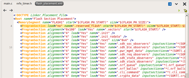

  • Hello Dimitra,
    The Peer Manager can be configured to delete the oldest bond to free up space in FDS for new bonds. This works fine as long as FDS is only used for storing bonding information. However, if FDS is also used for storing other application data, there is a possibility that the Peer Manager could be forced to delete the last and only bond. So, are you using FDS for storing other data in your application?
    Vidar
  • Yes we use FDS to save application data in flash.
    So, does this mean that there is a way to configure the peer manager to never delete the only one bond of the device or I should keep track of the free memory, and stop saving data early enough before the flash is trully full, and then peer manager will not be forced to delete the last and only bond? How can I do this, or where can I find how much space peer manager needs so that it never deletes the bonds? Or is there another way to handle this situation in general?
    best regards,
    Dimitra
  • Hi Dimitra,
    It's best to not perform GC too frequently as it leads to increased flash wear. Freeable words are not included in words used. Also, if possible, avoid running GC in connections as it can lead to scheduling conflicts. Running GC on this many pages is relatively time consuming.
    DimitraN said:
    if the limit of "full" space is 100 words. and words used = 100 and freeable = 10, and words used do not include freeable words, then i have exceeded the limit, and I will have a problem even if i call gc.
    This is correct. So in this case you would have to delete some records to get more "freeable" words.
    Vidar
