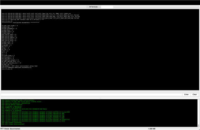

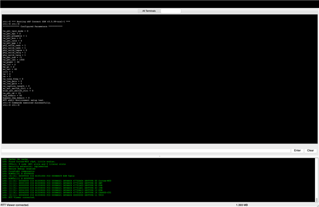

Hi, I am using a module named MS12SF1 (nrf5340 + nrf7002). I was trying to write the Mac address for one time programming by using radio_test sample code.
Before doing this I executed one more command which is wifi_radio_test show_config as per mentioned in https://docs.nordicsemi.com/bundle/ncs-2.6.1/page/nrf/samples/wifi/radio_test/sample_description.html this link
I tested this on 2 different modules and they are giving different results. Attaching 2 images to show the difference.
I wanted to know what exactly is the reason behind this as the modules are same

  • Thank you for sharing these, the pin outs in zephyr.dts seems to match the module you're using.
    Rakshita said:
    3.3V is going into the module
    This is within the electrical specs of both nRF5340 and nRF7002, so that should be OK.
    Rakshita said:
    Yes checked the soldering and actually we have around 15pcbs and we are facing issues in all of them but this was not happening with the older pcbs (which were exactly same, same module is used)
    If all, ie. 15 out of 15 devices, of your new PCBs are not functional, it is highly likely a hardware issue.
    When you say that the old PCB is exactly the same, do you mean that this is just a new batch of PCBs?
    Do you have equipment to do a swap-test between a good PCB and a bad PCB to see if the issue follows the module?
