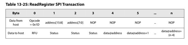

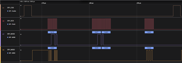

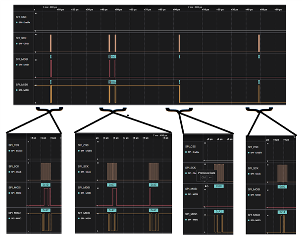

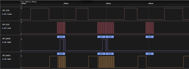

Initially I am trying to read the SX1262_REG_SYNC_WORD register with address 0x0740. As per SX1262 datasheet it's default value will be 0x14. But I am getting the value 0x00. The code is given below.
