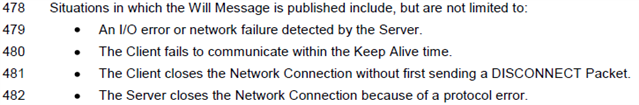

  • My understanding is that WILL message is NOT triggered by intentional MQTT disconnecting. Instead, broker will send the will of the client (obtained when connecting broker) in the case of below (MQTT 3.1.1).
    Zephyr MQTT API does not have reason code, because it's based on MQTT 3.1.1, and the feature is not available until MQTT 5.0.0.
