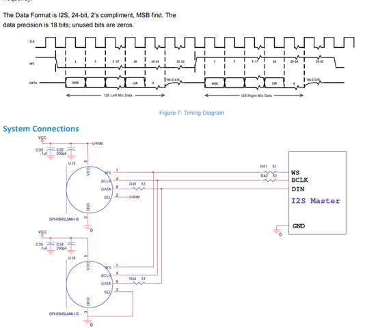

SPH0645 I2S MIC DATA FORMAT
Hi,I have been using nrf5340 audio DK Board to access the I2S .I am using SPH0645 mic with that i need to get mic data .My Mic datasheet specifies that "The Data Format is I2S, 24-bit, 2’s compliment, MSB first. The data precision is 18 bits; unused bits are zeros".Do I need to convert the value ? As it specifies data of 2's complement value in order to get original mic data or it will be internally converted by the nrf5340 controller itself.I am taking data size of 32 bit and in that I am taking 16 bit of each mic data and confirm me regarding data format whether to be Left-justified or Right-justified.I am attaching the Datasheet of I2s mic.

    Ok,thank's for that .I have doubt regard data ,I am trying to print data and convert to wav file,in this case do i need any conversion of 2's complement value to get original audio or this wont be necessary thing.Can I use directly what I get without converting 2's complement value?
    That should be fine, 2's complement is normal.
