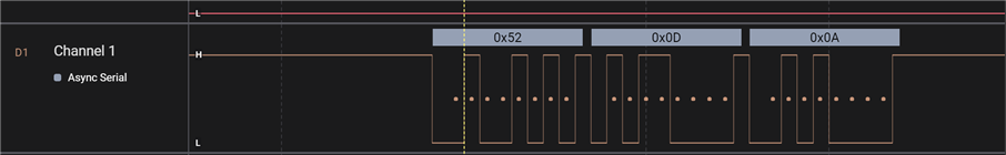

When typing "R" in the terminal i get a hex on the RX pin. P0.08 on the nrf52840, so that seems correct, but when sending from phone i dont get anything on any of the pins:
(on the terminal i get the correct string from the phone but not through the pins)

    It works! I also get the correct string on the logic analyzer from the TX from the nrf52840 (with bl to uart example).
    The problem is now that i have implemented the code below on the nrf9161 and connected TX (nrf52840) to RX (nrf9161):
    This code is supposed to receive a string through UART and it works for now by sending a string via the vscode terminal and it prints back that it received the string.
    So each nrf's works correct separately when testing.
    But when connecting both at the same time, they both get blocked, so now i dont get an response in the terminal from the nrf9161(UART receive) or when trying to send a string via BL via the phone on the nrf52840(BL->UART ex).
