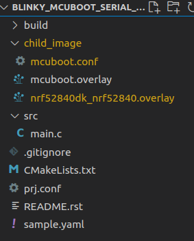

I am following the tutorial to implement the serial recovery on nrf52840DK https://academy.nordicsemi.com/courses/nrf-connect-sdk-intermediate/lessons/lesson-8-bootloaders-and-dfu-fota/topic/exercise-1-dfu-over-uart/
It works with the default setting, but when I added an overlay to remap to other pinouts and then connect with FT232 to linux, it never worked with the following line, NMP timeout.

overlay:
&pinctrl {
	mcumgr_uart_default: mcumgr_uart_default {
        group1 {
			psels = <NRF_PSEL(UART_TX, 1, 2)>;//, 29
				//<NRF_PSEL(UART_RTS, 0, 27)>;
		group2 {
			psels = <NRF_PSEL(UART_RX, 1, 1)>;//, 28
				//<NRF_PSEL(UART_CTS, 0, 26)>;
			bias-pull-up;
	mcumgr_uart_sleep: mcumgr_uart_sleep {
		group1 {
			psels = <NRF_PSEL(UART_TX, 1, 2)>, //29
				//<NRF_PSEL(UART_RTS, 0, 27)>,
			low-power-enable;
&uart0 {
	//current-speed = <1000000>;
    current-speed = <115200>;
	status = "okay";
	pinctrl-0 = <&mcumgr_uart_default>;
	pinctrl-1 = <&mcumgr_uart_sleep>;
	//hw-flow-control;
&spi1 {
	status = "disabled";
&i2c0 {
	chosen {
		zephyr,uart-mcumgr = &uart0;
