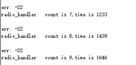

    I tried counting and updating in that callback.
    By combining the (link: academy.nordicsemi.com/.../) Exercise 2 and (link: https://devzone.nordicsemi.com/f/nordic-q-a/75374/radio-notification-in-ncs) a sample called 6013. The peripheral_limited_adv. Zip
    the result:
    It looks like I used bt_le_adv_update_data incorrectly.
    -22 mean  EINVAL
    Is this solution theoretically sound, and how can I fix it?

    2. Seems like you've set the bt_le_adv_update_data() params for bt_data and size are set to NULL and 0 respectively, which would be my guess to what this invalid argument error is caused by. I can't say I understand what you're trying to do here though, and in general I don't think counting the advertisement index will be possible.
