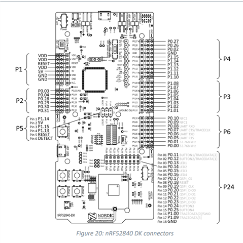

  • How can I now find out which pins on the nrf52840dk board are unassigned?It is possible to configure a new UART with unassigned pins?
  • This reply explains this:
    AHaug said:
    You can find an overview over them on the backside of the DK or in the datasheet for the nRF52840DK.
    Have a look at chapter 4, and specifically 4.6 in the datasheet.
    Andreas

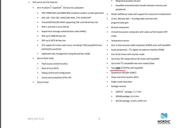

  • I did not find any of the freely available gpio pins.Can you help me with this
  • Yes I can, here's some pointers
    If you open the datasheet and navigate to Figure 20 in chapter 4.6 you will see an overview over the connectors on the nrf52840DK. It should look like this.
    Some of the GPIO's does only have a Pin number text, while others does have a grayed out text beside them. The ones that has a grayed out text beside them are GPIO's that have been wired physically on the DK to something on the DK. You will also find this same image and list of used and un-used GPIOs on the back side of the DK you're using.
    For instance, see that P0.13-0.16 are reserved for LEDs, while P0.09 and P0.10 are reserved for NFC, and the predefined UART that you can see in 3.2 that you can use for UART logging, or in the UART lesson in the academy. You can in some cases use the occupied GPIOs for other things, but that requires physical interference with the DK.
    Instead you should find a set of GPIO's that are not used. These are any of the GPIO's on P2, P3 and P4 and connect your devices that will communicate with each other over UART together with them.
