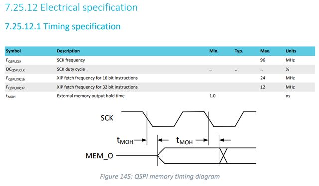

As noted in other discussions, like the one I've linked below, there is no timing information for the QSPI interface. Can Nordic please provide the timing information for the QSPI interface?
Similar request from two years ago here:  nRF52840 - Detailed timing specification on QSPI peripheral
