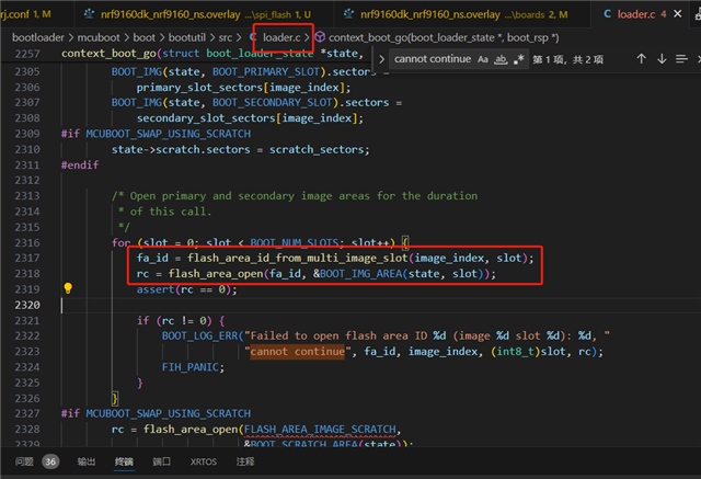

Thank you for your reply. I have deleted build folder and compile again.
the ovlerlay file have added a new node, this is below:17646.nrf9160dk_nrf9160_ns.overlay
My question is:Is it necessary to partition the flash space from 64Mb to 32Mb in the bootloader.? Because the error message below indicates that Area cannot be found.
Thank you very much!
pengfeilaw said:My question is:Is it necessary to partition the flash space from 64Mb to 32Mb in the bootloader.? Because the error message below indicates that Area cannot be found.
When using mcuboot, you need to configure it to handle the SPI flash.
That is done by setting up a myproject/child_image/mcuboot.conf file containing something similar to this setup:
