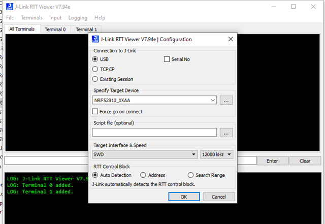

I am currently developing a project using the nRF52810 as my controller and SEGGER Embedded Studio (version 5.42a) as my IDE. I have successfully integrated the Timer and SAADC peripherals into the ble_app_uart/pca10040e/s112 example project from the nRF5 SDK.
My problem is that I can't use J-Link RTT Viewer for debugging. When I open the J-Link RTT Viewer and connect it to my board, I can't see any debug messages or information in the RTT console. What could be the reasons for this? Is there any SDK configuration macro that needs to be enabled or disabled to use the RTT Viewer, or could the problem be related to the connection parameters?

    Do you see the RTT log if you start a debug session in Segger Embedded studio instead? Have you also tried this with the original ble_app_uart example?

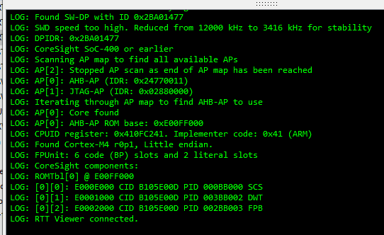

  • hi ,  ,I just checked the example app_ble_uart_pca10040e_s112 code in debug mode while connecting it to JTAG. The debug terminal does not display anything. What could be the reason for that?
  • hi ,  I'm having some trouble displaying logs to the rtt viewer , I can see the logs with SES Debug Terminal but not in RTTviewer .
  • I asked you to confirm that RTT logging works in SES with your modified example, as I need to ensure I understand the details. Also, I asked earlier if you have periodic logging after startup in your project.
  •  , Yes, I'm checking the periodic log messages. I will attach the code for better understanding, The RTT viewer couldn't display anything.

  • You are not processing the log buffer in your main loop like the original ble_app_uart example. If you don't want to do this, you need to enable In-place processing by setting NRF_LOG_DEFERRED to '0'.
    log_init() shall also be called at the beginning of main() before printing any messages.
  •    , Thank you very much for your valuable response. I changed the NRF_LOG_DEFERRED value from 1 to 0, and now the RTT viewer is displaying the NRF_LOG messages.
