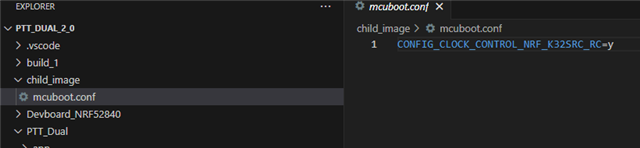

I have a very strange problem and i can not found any solution.
I have NRF52833DK and NRF52840DK where mi code is working perfectly.
Compiled with OTA is ok, compiled without ota is OK.
I have my custom device with NRF52833QDAAA Chip with this proble:
when my code is builded whitout OTA is working perfectly.
When i add this 2 line of code (for OTA and bootloader):
CONFIG_BOOTLOADER_MCUBOOT=y
CONFIG_NCS_SAMPLE_MCUMGR_BT_OTA_DFU=y
My code stop working. I can not connect anymore my custom device with NRF Programmer, i need to restore the device with reset button, erase all and then I can program again my device. I can not undersand why.
I have same behavior when I use the default code of Peripheral HRS.
Someone can help me??
