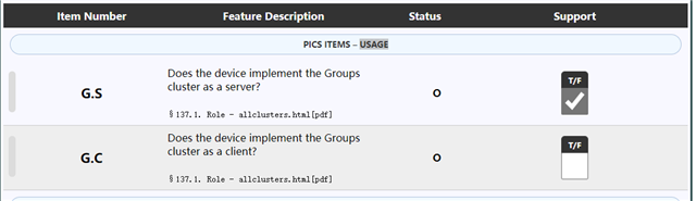

Hi. experts, I tested [TC-ACE-1.2] Subscriptions with Test harness, which is UI-Python. I execute it on Docker,./certification-tool/scripts/otbr/otbr _ start.sh; And write the parameters into the Test harness configuration, but the following error occurred when starting the test. Why? I tested the UI-Automated project successfully.

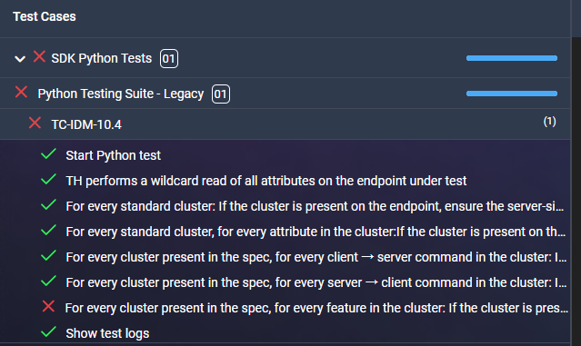

    Thanks for the reply, I know the problem and solved it, but there are a lot of bugs in the UI-Python test, please help me again。
    1.  I test "TC-IDM-10.4“,The error appears in "For every cluster present in the spec, for every feature in the cluster"。
    The error message is as follows:
    TC-IDM-10-4_2024_10_22_15_37_52.log
    example:

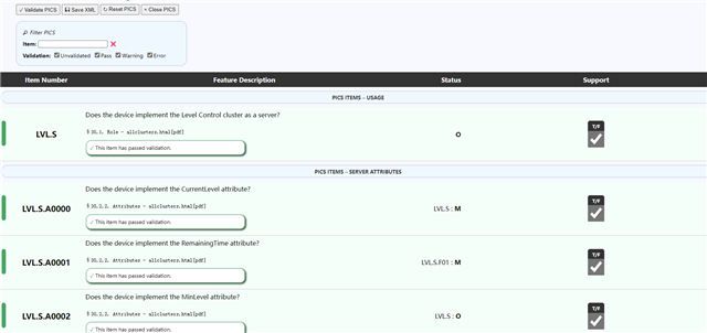

    ”Endpoint: 0, Cluster: 8 (0x08) LevelControl, Attribute:0 (0x00) problem: PICS LVL.S.A0000 found in PICS list, but not on device spec_location: [MatterTest] 10-22 07:39:16.198 INFO Problem: ProblemSeverity.ERROR test_name: PICS check location: Endpoint: 0, Cluster: 8 (0x08) LevelControl, Attribute:1 (0x01) problem: PICS LVL.S.A0001 found in PICS list, but not on device spec_location: [MatterTest] 10-22 07:39:16.199 INFO Problem: “
    These commands are enabled on DUT, why do I get this error????????

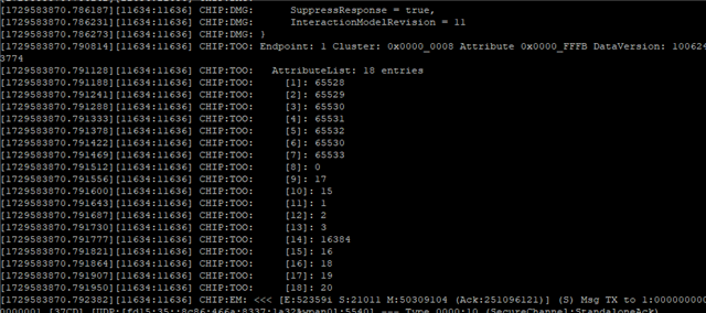

    Here's what I read by command, it's there: ”./chip-tool levelcontrol read attribute-list 1 1“

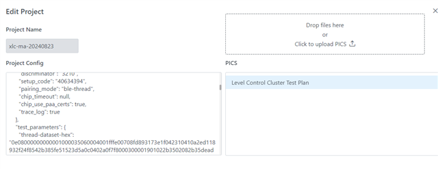

    1.  I'm using TestHarness auto-test "TC-IDM-10.4
    So, I don't know how to specify test endpoint 1.
    Please teach me how to configure. Thank you
