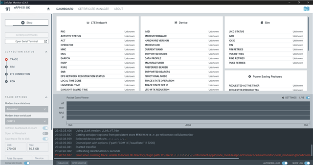

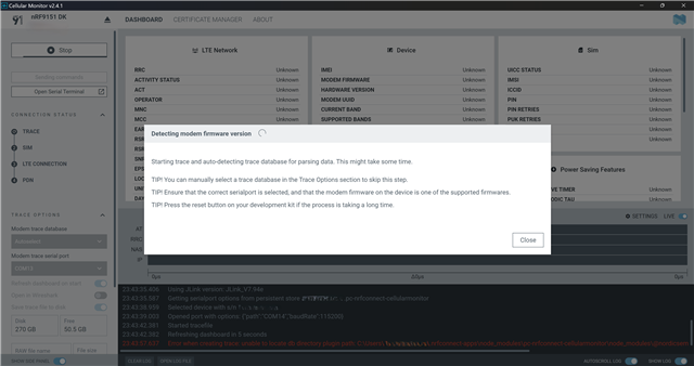

    For the modem traces, I activated the CONFIG_NRF_MODEM_LIB_TRACE and CONFIG_AT_HOST_LIBRARY flags and used Cellular Monitor v2.4.1 from the nRF Connect for Desktop v5.0.2 application, but I got the following error:
    Error when creating trace: unable to locate db directory plugin path: C:\Users\xxx\.nrfconnect-apps\node_modules\pc-nrfconnect-cellularmonitor\node_modules\@nordicsemiconductor\nrf-monitor-lib-js\Release\win32-x64\nrfml-insight-source.nrfml
    How can I solve this problem?
    Could you please provide more information about this, e.g. screenshot of your Cellular Monitor?
