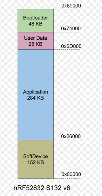

I have a problem about MBR and Bootloader memory (at address 0x74000). I am using nRF52832 S132 v6.
My purpose is that I can upgrade bootloader from inside main application. My ideal is that I will overwrite a new bootloader into the current bootloader when run inside main application.

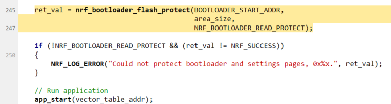

I found a line code in the bootloader source code that I based on the example code SDK.
It already protected the MBR & Bootloader memory before running main application.
Therefore, I can not access the Bootloader memory.

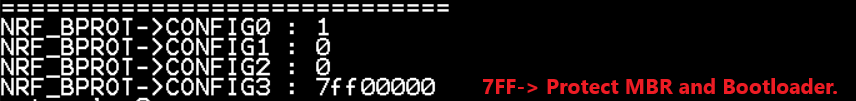

Inside Main application, I tried to read the BPROT (Block protection) register and change the value of it by function "sd_flash_protect()". But it didn't work.
So, do we have another way to write into bootloader memory from inside Main Application ?
