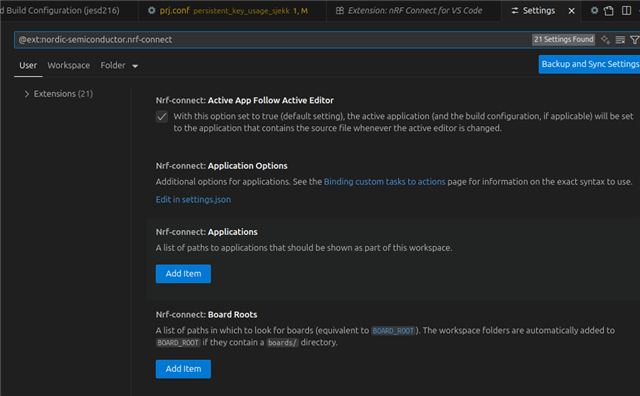

Hi there,
Under lesson 3 of devAcademy
https://academy.nordicsemi.com/courses/nrf-connect-sdk-intermediate/lessons/lesson-3-adding-custom-board-support/
There is an "important" mention stating this
The lesson covers how to define boards in the nRF Connect SDK up to version 2.6.1. It’s important to note that starting from version 2.7.0, the nRF Connect SDK uses a new hardware model (Hardware Model V2), which is not covered in this lesson.
Where / When would support be available for adding custom board support when using the latest nRF Connect SDK version 2.7.x
Thank you

  • Sorry for the delay.
    Both options are fine, If this is only on one computer I would recommend using the add item in VScode.
    As I might create building project with different custom boards I have created a custom board folder inside the folder where I store customer projects. So For any project I would be able to find it there and it require the least amount of modification on my side.
    Regards
    Runar
