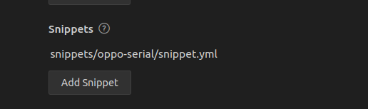

I have created a Zephyr Snippet (derived from the cdc-acm-console sample).
I am unable to select it in the Build Configuration. It is listed in the dropbox where the sample snippets are listed. When I add it via Browse, I can only select files, not a directory. Thus I am selecting the snippet.yml in my directory. This adds the file to the snippets:
Which is given as is to west:
west build --build-dir /home/markus/ncs/v2.6.1/zephyr/samples/hello_world/build /home/markus/ncs/v2.6.1/zephyr/samples/hello_world --pristine --board nrf52840dk_nrf52840 -- -DNCS_TOOLCHAIN_VERSION=NONE -DSNIPPET=snippets/oppo-serial/snippet.yml

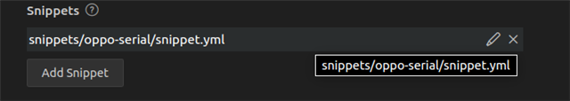

West ist able to see the snippet under its name, but complains that it is given as snippet.yml
I am unable to change this via the pen:
Since that is not editable.
Custom snippets are thus broken currently.

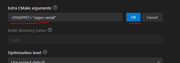

    Q2: Can you try storing it either in ncs\nrf\snippets, or in ncs\zephyr\snippets, and then use the the additional "Extra CMake argument":
    -DSNIPPET="oppo-serial"
    Like this:
    Does that work with your snippet?
