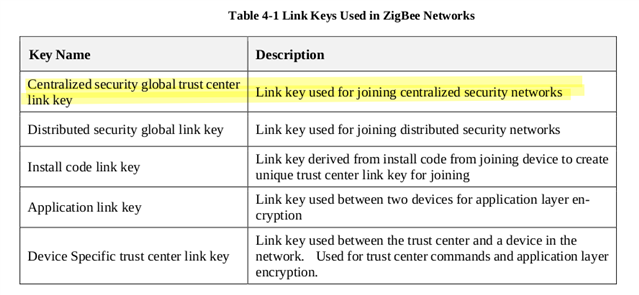

  • This is nothing to worry about. It's actually required by the spec that the default global trust center link key is the ZigBeeAlliance09 key (from Zigbee spec 4.2.1.2.1 Security Keys):
    It's just the link key used for joining centralized security networks (networks with a trust center/coordinator), but it is not the Zigbee network key

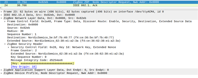

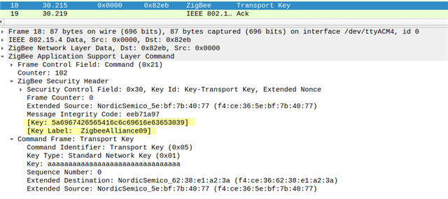

    Here you see an example where I have set the nwk key to aaaaaaaaaaaaaaaaaaaaaaaaaaaaaaaa. The ZigbeeAlliance09 key is used to encrypt the the application layer in the first Transport Key. This is the command where the TC sends the network key.
    After the device has received the nwk key, it will switch to using this.

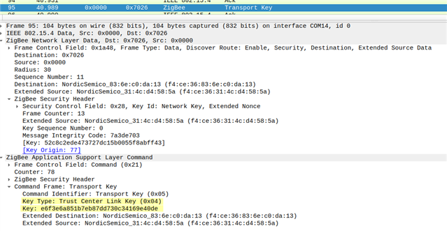

    It also receives a device specific TC link key (in the second Transport Key command), which will be used for any application layer encryption
