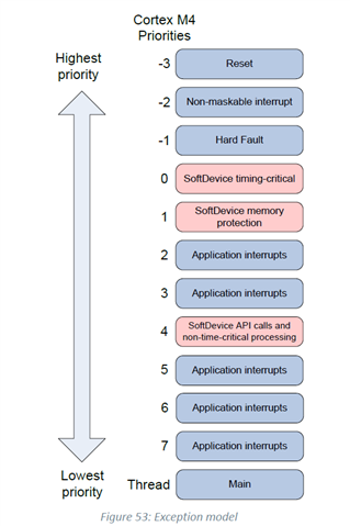

    I suspect that there could be a problem of the functions you call in the on_adv_report(). The context level of the event handler is at Softdevice low (level 4)
    There could be a chance that calling usb_printf_variadic() inside that context causing a problem. Please try to comment out usb_printf_variadic() and test printing out log on UART or RTT (or use GPIO) to see if you still see the problem.
    If usb_printf_variadic() actually a problem, you can consider using a semaphore or use software interrupt to reduce the context to main for example, before calling the funtion.
