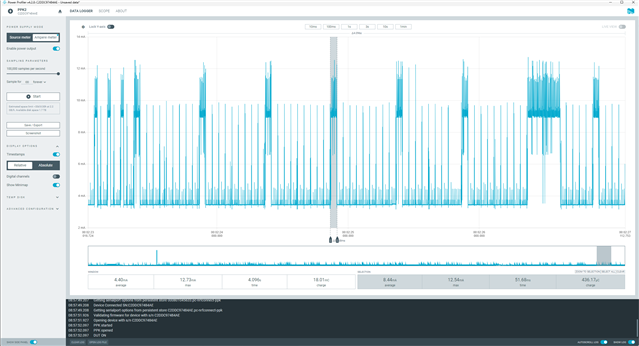

2.6.2

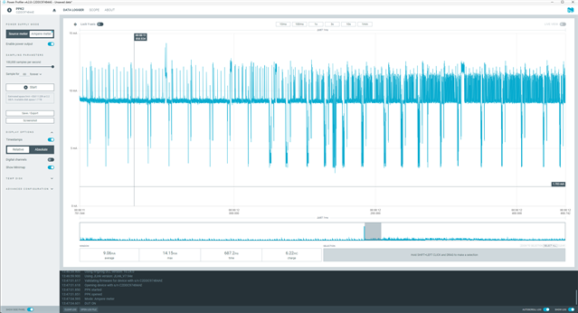

2.7 peripheral connected

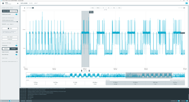

2.7 peripheral not connected
  • Hi Edward,
    Indication should have a confirm in 30 seconds. This could be the reason why you saw a lock up in 30 seconds.
    If it's the case, then the issue can be with the peer device, not the one who sends the indication.
    Could you try to capture a sniffer trace when you test with indication ? The trace would provide the information about what cause the issue.
    Please also capture a trace when you do notification, we can check if it's hitting the max bandwidth. This can explain error -12 when doing notification.
