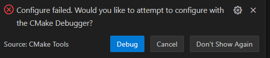

I am also getting a pop up in the corner of Visual Studio that shows the following:
I am not sure what could have changed.

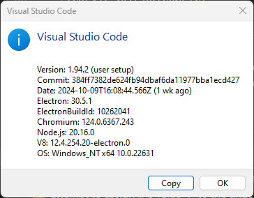

I have uninstalled Visual Studio Code and reinstalled the latest as of October 10, 2024.
I validated both toolchains through the visual studio
