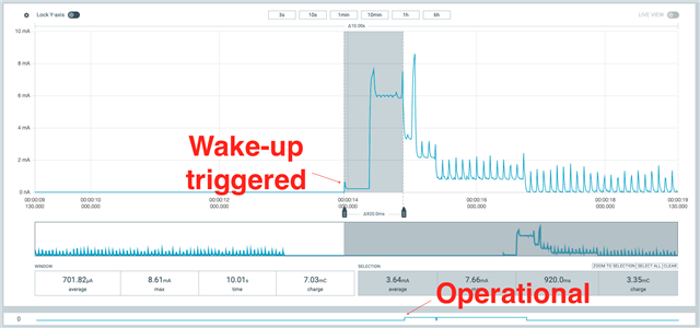

We're experiencing up to 1s of delay between waking up from SYSTEMOFF mode and executing from main. The traces from PPK show when the wakeup is triggered from an external source (button) and a GPIO toggles on to show when main is executing code - this is the first instruction inside my main func.
Current prj.conf settings:

My understading is that using the internal RC LFCLK is faster on boot-up than using an external one but so far, it has not made a difference.
Any pointers from here would be appreciated. Thanks!
