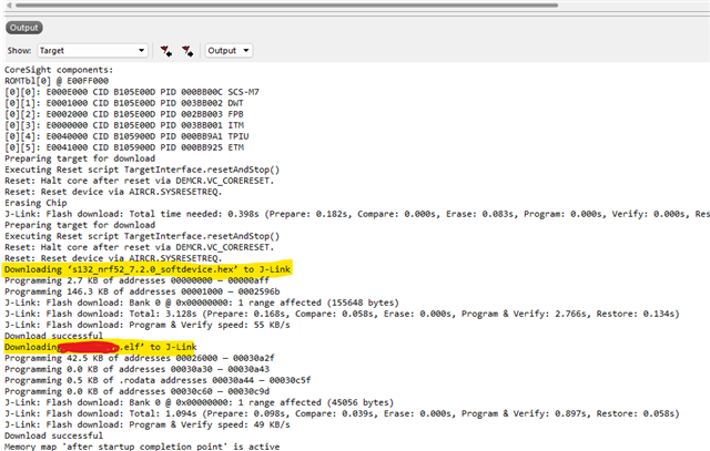

    About your questions: the devices were programmed in the first place (in a wired way) using Segger with a nRF52840-DK as a J-link bridge to the device's SWD port. Actually I know the app loaded were just the app (and it didn't include a bootloader inside the app), My assumption at the first moment was that maybe Segger (because a linking configuration setup) loaded a softdevices before the application. AND maybe it loaded a standard bootloader (signed or not). My thought was If it exists a standard bootloader loaded unwittingly by Segger, maybe in the forum were standard ways to deal with it.
    I replicated the flashing process described above, and noticed that there IS a softdevice step, and then the application downloading (I striked the app name for security reasons)
    If I'm understanding properly no bootloader is loaded in the device.

  • JKP said:
    Is still a chance (even if tricky, but without physical access of course) to update application or bootloader over the air?
    No. There is absolutely no way to update the firmware without a bootloader.
    JKP said:
    buttonless DFU method as instance
    That is not a bootloader. That is a bluetooth service indicating that the device has a bootloader, and is used as a method of putting the device in DFU mode. It does not work without a bootloader.
    I understand that you want to update the device without physical access, but it is not possible. Then you need to physically flash a bootloader first, and a way to enter the bootloader in DFU mode (ble_app_buttonless_dfu).
