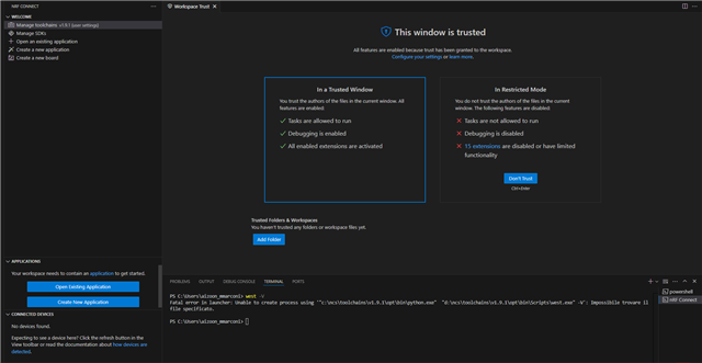

I have been trying to correctly setup my nRF Connect inside VS Code.
When I try to execute the command
west -V
in a nRF Connect window inside VS Code, I get the following error :
Fatal error in launcher: Unable to create process using '"c:\ncs\toolchains\v1.9.1\opt\bin\python.exe"  "d:\ncs\toolchains\v1.9.1\opt\bin\Scripts\west.exe" -help': Impossibile trovare il file specificato.

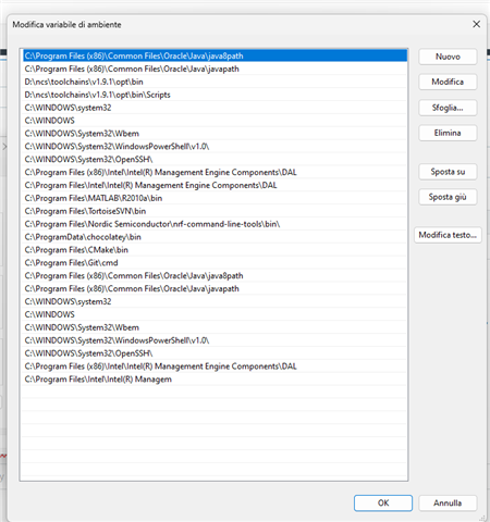

My PATH environmental variables seem to be correct. I have
and
but there is no mention of the c:\....
It feels to me like nRF Connect is pointing towards a wrong python.exe.
My python.exe resides in d:\ncs\toolchains\v1.9.1\opt\bin\
How can I fix this and let it work properly?

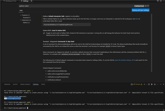

The same behavior also happens if i navigate to the correct Scripts folder and execute a powershell from there. This is the error i get.
PS D:\ncs\toolchains\v1.9.1\opt\bin\Scripts> west -V
Fatal error in launcher: Unable to create process using '"c:\ncs\toolchains\v1.9.1\opt\bin\python.exe" "D:\ncs\toolchains\v1.9.1\opt\bin\Scripts\west.exe" -V': Impossibile trovare il file specificato.

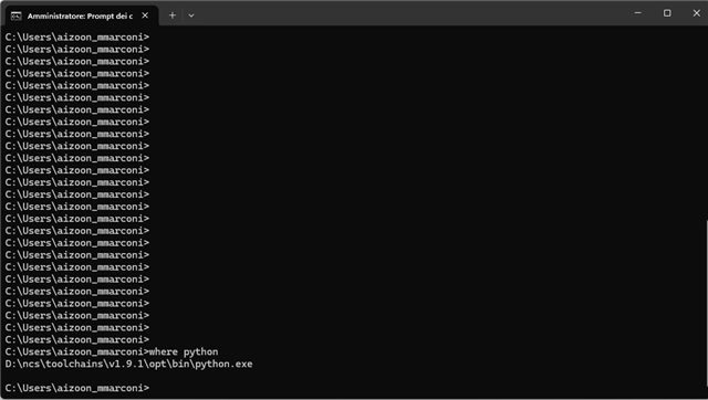

In case I ask my system "where python" in a PS this is what i get:
where python
D:\ncs\toolchains\v1.9.1\opt\bin\python.exe
Which aims to the correct location.

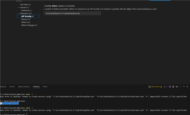

It feels to me like some of the components are aiming at the wrong location but I cannot find who or where.
