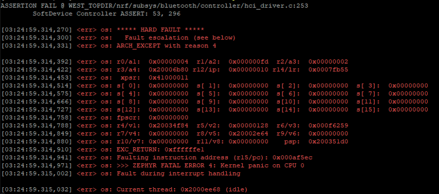

We have a BLE product using the nRF52840 and nRF Connect SDK. After upgrading our firmware to use nRF Connect v2.6.2 we intermittently get this assert from the SoftDevice controller:
Is there any info on what may cause it?

The assert indicate that the SoftDevice Controller was not able to perform an operation on time. Typically, this means soemthign else blocked it, like a high prority interrupt taking long time, or similar.
Thank you. I assume this error is not recoverable and we need to reboot the module?
Yes, that is correct.
