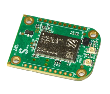

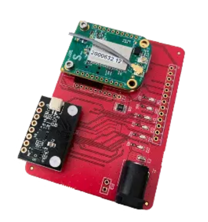

I am working with the Signetik M1-N1 module, which is using the nRF9160 chip, as well as the DEV-M1-N1 breakout board, for evaluation and development:

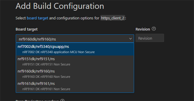

Since this module is using an nRF9160 chip, I was wondering if there was any support by NXP for devices from other manufacturers like Signetik. I have worked with the 9160DK in the past to establish https client connections to various web servers by using the https_client example application from the SDK, and I am attempting to do something similar with these devices.
Any help would be greatly appreciated.
