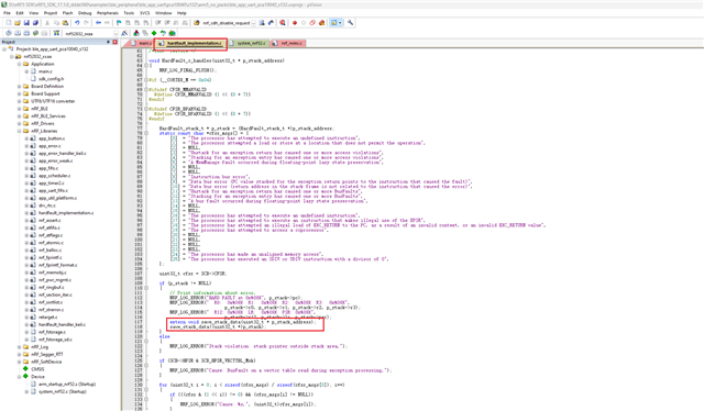

case about nRF52832 HardFault_Handler data save to flash
How to solve the problem of writing data to flash using the write_data_flash function in save_stack_data function
1.1. I tried to add the function save_stack_data to the function hardfault_implementation.c file HardFault_c_handler to save the stack data of HardFault to the address specified by FLASH, but an error occurred.
But I tested write_data_flash in the flash_init function as normal
2.code

3.I do need to save the following stack error message to flash
4.Refer to the following information for more error information
Thank you for all your assistance.
Peter.Min
    You cannot use fstorage API calls from the Hardfault handler as that uses interrupts. If you want to write to flash, you need to do it low-level and blockign without using interrupts (you can refer to the code writing to UICR in modules/nrfx/mdk/system_nrf52.c for an example of that).
    That said, the most common way to store crash data in such cases is to use a noinit arrayin RAM and write the data together with a checksum before resetting. Then at startup, check the RAM buffer and if it has data and a valid checksum, handle that as needed (perhaps write it to flash at this point, or do somethign else you need). Note that the reason you need the checksum is that the content of the RAM is not guaranteed during soft reset, so you may sometimes loose data. But in practice, the data will be intact most of the time.
    Einar
    The FLASH and UICR read and write functions have been updated
    Please help me troubleshoot the reason why I failed to write FLASH/UICR by calling save_stack_data in the file hardfault_implementation.c function HardFault_c_handler
    1. I updated the flash and uicr read and write code to test the hardfault is invalid as follows:
    2. I tested flash and uicr read and write code in the test function, as shown in the following figure ok
    3. I have tested ram flash uice read and write in hardfault, as shown in the figure below; ram ok flash and uicr failed

    #include "nrf_nvmc.h"
    #include "nrf_sdm.h"
    #include "nrf_delay.h"
    typedef enum
        ERROR_NULL_POINTER,        // 空指针解引用
        ERROR_OUT_OF_BOUNDS,      // 越界访问
        ERROR_STACK_OVERFLOW,     // 堆栈溢出
        ERROR_UNALIGNED_ACCESS,    // 未对齐访问
        ERROR_DIVIDE_BY_ZERO,      // 除以零错误
        ERROR_ILLEGAL_INSTRUCTION, // 非法指令
        ERROR_DATA_STORAGE,        // 数据存储错误
        ERROR_INTERRUPT_PRIORITY,   // 中断优先级错误
        ERROR_SYSTEM_CALL,        // 系统调用错误
        ERROR_MEMORY_ACCESS        // 内存访问冲突
    } HardFaultError;
    //注意:只能使用nrfjprog --recover擦除UICR
    //注意:只能在SOFTDEVICE禁用或使能前写UICR
    //注意:UICR擦除后每个字节只能写一次,即只能从0xFFFFFFFF修改为 0x00000000
    //注意:需要频繁修改断电保存的数据,更适合用FDS
    //保存堆栈信息到FLASH/UICR/RAM
    #define FLASH_STACK_ADDRES 0x0007F000
    #define UICR_STACK_ADDRESS 0x10001080
    #define RAM_STACK_ADDRESS 0x2000F000
    void write_data_to_uicr_or_flash( uint32_t address, uint32_t *p_stack_address ) // 传递堆栈地址以供写入
        uint32_t *dest = (uint32_t *)address;
        if(dest[0] == 0xFFFFFFFF && dest[1] == 0xFFFFFFFF)
            //打印数据保存的地址和内容
            for(uint8_t i = 0; i < 8; i++ )
                NRF_LOG_INFO("save stack address[%d]: = %08X  value: = %08X", i, &dest[i], p_stack_address[i]);
                nrf_delay_ms(10);
            nrf_delay_ms(500);
            //禁用softdevice
            static uint8_t sdh_state = 0;
            if( nrf_sdh_is_enabled() )
                sdh_state = 1;
                nrf_sdh_disable_request();
            //nrf_nvmc_write_words( address, p_stack_address, 8);
            // Enable write.
            NRF_NVMC->CONFIG = NVMC_CONFIG_WEN_Wen;
            while ( NRF_NVMC->READY == NVMC_READY_READY_Busy ) {};
            __ISB();
            __DSB();
            for (uint8_t i = 0; i < 8; i++)
                ((uint32_t*)address)[i] = p_stack_address[i];
                while (NRF_NVMC->READY == NVMC_READY_READY_Busy) {}
            NRF_NVMC->CONFIG = NVMC_CONFIG_WEN_Ren;
            __ISB();
            __DSB();
            NVIC_SystemReset();
            //启用softdevice 实际上运行不到此处
            if( sdh_state )
                sdh_state = 0;
                nrf_sdh_enable_request();
    void save_stack_data ( uint32_t *p_stack_address )
        //保存数据到RAM
        uint32_t *ram_dest = (uint32_t *)RAM_STACK_ADDRESS;
        for( uint8_t i = 0; i < 8; i++ )
            ram_dest[i] = p_stack_address[i];
        //打印FLASH/UICR数据
        uint32_t address = FLASH_STACK_ADDRES;  //UICR_STACK_ADDRESS;  //FLASH_STACK_ADDRES;
            NRF_LOG_INFO("dest[%d] addr = %08X  value: = %08X", i, &dest[i], dest[i] );
            nrf_delay_ms(10);
        //保存数据到FLASH/UICR
        write_data_to_uicr_or_flash( address, p_stack_address ); //写入测试数据
    void test(void)
        uint32_t stack_data[8] = {0x11111111, 0x22222222, 0x33333333, 0x44444444, 0x55555555, 0x66666666, 0x77777777, 0x788888888};
        save_stack_data ( stack_data );

    I do not see any immediate issues with how you are writing to flash. Did you debug to see if there was an error of some sort before completing the write_data_to_uicr_or_flash() function?
    PS: You should not store this data in the UICR. The UICR is used for persistent data (including some persistent configuration registers), and cannot be deleted).
    PSS: Writing to flash can only flip bits from 1 to 0, so if you are re-using this flash page you need to erase the page before writing to it.
  • Hi Einar Thorsrud,
    The following code exception caused the failure to continue
    sdh_state = 1;
    Peter.Min
