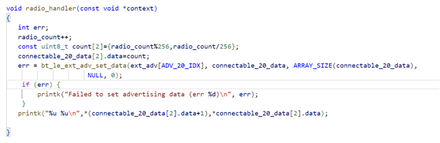

我使用 NCS 2.5.0,radio_notification,无线电处理程序。
我想在每次启动天线时递增,并将 的值写入通告数据包。ii
在函数 中,调用 会导致开发板每次崩溃。radio_handlerbt_le_ext_adv_set_data
你能帮我吗?

  • Hello, thank you very much for your patient explanation.
    The issue causing the DK to crash is not the variables I mentioned, but rather the bt_le_ext_adv_set_data function.This code runs well after commenting out the bt_le_ext_adv_set_data function, but uncommenting it causes the DK to crash.
    What I want to know is whether it is possible to call bt_le_ext_adv_set_data in the interrupt callback function radio_handler to update the broadcast packet data. If it's not feasible, how should I update the broadcast packet data within radio_handler?

  • Hi Allen
    I'd recommend checking out how the bt_le_ext_adv_set_data() function is set in other samples as I don't think it's generally a good idea to have it within an interrupt callback which usually is very timing sensitive. In I.E. the Distance measurement sample, the bt_le_ext_adv_set_data() function is called within the adv_start() function initially, and then within an adv_update_data() function if the advertising set data needs to be updated during runtime. Also note that "when updating the advertising data while advertising the advertising data and scan response data length must be smaller or equal to what can be fit in a single advertising packet. Otherwise the advertiser must be stopped." (from bluetooth.h in ...\zephyr\include\zephyr\bluetooth\bluetooth.h
