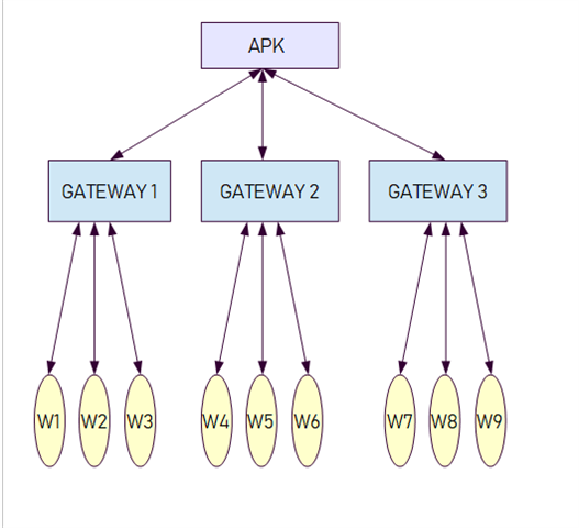

SILTVM
W1 TO W9 are the timer devices

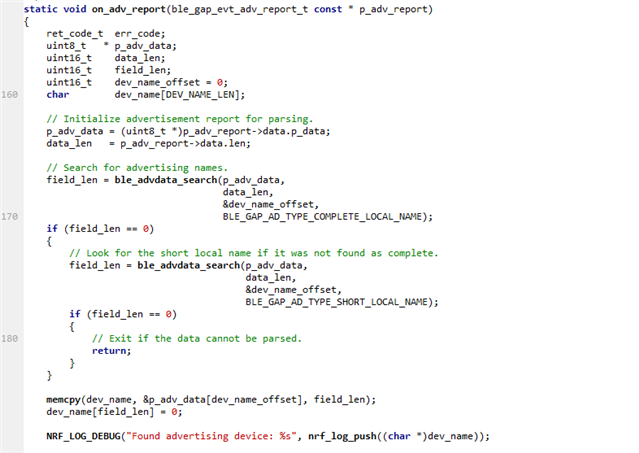

    You can listen to the BLE_GAP_EVT_ADV_REPORT when scanning and can parse the advertising packets to get the name, address. Please take a look at the \examples\ble_central\experimental\ble_app_hrs_nfc_c , in ble_m.c you can find how the advertising packets are parsed in on_adv_report():

    We need the gateway device to act as both a central and peripheral. Initially, the gateway device advertises as a peripheral, allowing it to connect via BLE using the nRF Connect app. Once the connection is successful, the gateway acts as a central, scanning for available nearby watches. It then sends the available devices' MAC IDs and advertised names to the app. The app will then send a command containing the MAC ID and BLE name of the desired watch to connect with the gateway device. The gateway then acts as a central to connect with the specified watch and The gateway device should provide the capability to send and receive commands between the app and watches.
    Number of Timer Indicators(watches):
    We haven’t set a limit on the number of watches that can connect to the gateway device at a time. It may be fewer than 20 .
    Distribution Distance Between Watch and Gateway:
    • The distance between the watch and gateway device is approximately ≤ 100 meters.
    • The distance between the gateway and nRF Connect app is also ≤ 100 meters.
    The purpose of implementing a gateway device between the watch and the nRF Connect app is to extend the communication range.

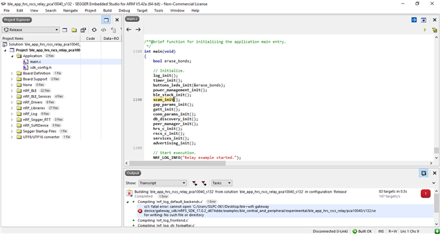

  •  , I see the example project ble_app_hrs_rscs_relay available in the BLE central and peripheral SDK directory, but when I try to build the code, an error occurs initially. I am attaching a screenshot for better understanding
  • Hi Siltvm,
    It seems that the path is too long. Please try to copy the SDK to a folder near C:\ . You can rename the SDK folder from nRF5_SDK_17.0.2_dd674de to for example SDK1702. Windows only allow max length of the path to 250 characters.
    I don't see a problem with your set-up. Note that the gateway doesn't have to connect to all the watches at the same time. It can connect, read data and disconnect to connect to more device. This way even if you have more than 20 watches you still can get data from all of them. Of course if you have less than 20, you can just keep connections and don't have to do connect-disconnect.
    If you keep the connection, avoid using too short connection interval. Try 100ms and higher.
