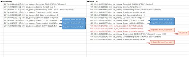

  • >Do you have an application log which you could send?
    Here is the log gotten by EVK.
    Is there anything you think might be the cause?
