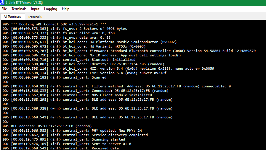

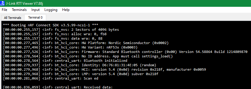

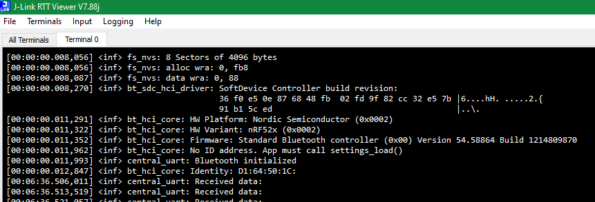

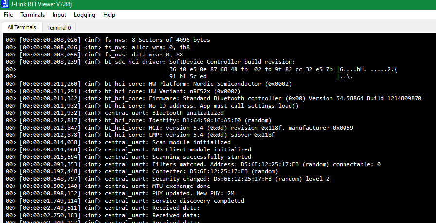

I am checking difference between timestamps in every data packet (timestamp is from peripheral device, so it is from the sending moment).
When I connect peripheral device with nRF Connect app on android phone everything is OK. Difference between timestamps are 8ms sometimes 9ms.
But when I connect peripheral device to Multi NUS there is problem. Every 5th data packet have bigger difference in timestamp.
Interesting is it, that average difference between data frames is about 12 ms. It doesn't matter if peripheral device is sending data every 8ms or every 10ms average is 12ms, because in 8ms case difference between 4th timestamp and 5th timestamp is bigger than in 10ms case.
Annother interesting thing is it, that when I connect second peripheral device to Multi NUS it's not worse, but this problem happens for two devices.
I am sending data (17 Bytes) every 8ms, but I have problem with receiving it with Multi NUS application.
