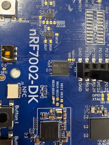

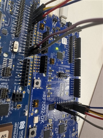

Connecting nRF9160DK and nRF7002DK
I've linked the pin to be the same as that ticket.
Board nRF9160-DK(P3 & P4) nRF7002-DK (P24)
SPI CLK P0.13 P0.17
SPI CS P0.10 P0.18
SPI MOSI P0.11 P0.13
SPI MISO P0.12 P0.14
HOST-IRQ  P0.07 P0.23
IOVDD-CTR  P0.00 P0.31
BUCKEN P0.01 P0.12

  • I found the problem.
    The connection between the two boards was faulty with the line corresponding to the IRQ. When I replaced the wire, I was able to get the Wifi signal normally.
