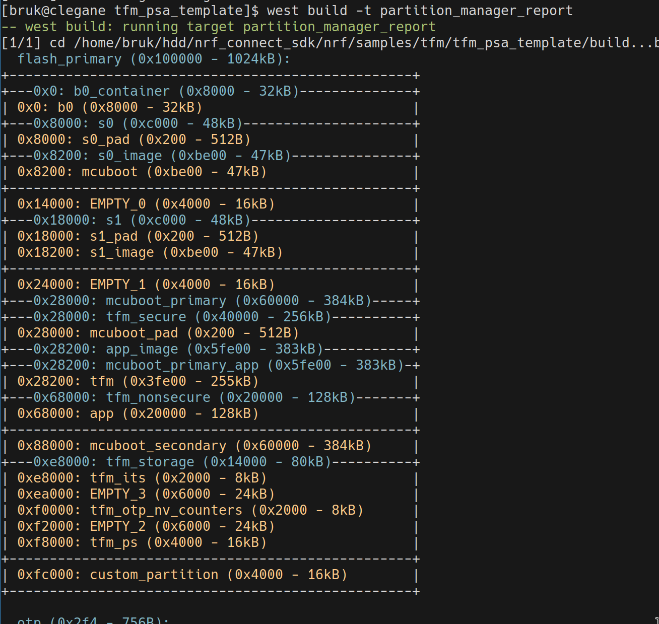

I have read through the nRF Connect SDK documentation, however it is not clear to me how the Partition Managed is used to configure fixed flash partitions for targets using TF-M. Could you please provide an example partition configuration on the nRF9160 (using internal flash) with: dual-slots for secure / non-secure images, secure storage (i.e. certificates), event storage (for telemetry) and configuration?

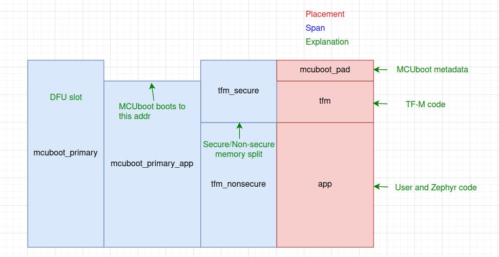

    Mark that there are differences between "span" and "placament". "Span" overlaps other partitions, while "placement" has a specific place in code. "Span" is thus mostly to describe sets of other partitions.
    • app: The "app" is where the zephyr application lives. This is the default partition and is always automatically generated by the partition manager.
    • app_image [span]: NSIB uses this when there is single bootloader. I don't think this one is used for dual bootloaders, but I might have missed some subtlety. For NSIB only, this is the address NSIB will boot to after the bootloader I think.
    • mcuboot_pad [placement]: MCUboot needs to store some metadata per image. Size 0x200. You see 0x200 repeat in the offsets right. Could more clearly have been named "mcuboot_primary_pad" to match the below name.
    • mcuboot_primary_app [span]: In your case, this overlaps with "app". But if we got direct-xip mode for MCUboot, we want two different app partitions, so then we also will have mcuboot_secondary_app. These have the address mcuboot will boot to after the bootloader.
    • mcuboot_primary [span]: We want to know the whole MCUboot primary (app + pad) to be under one. The full DFU binary goes into here, cause that has both image and metadata.
    • mcuboot_secondary [placement]: When updating the application, you want to swap it in. MCUboot secondary is generally for this.
    • tfm [placement]: The tfm application. This is code that runs, just as the app. Must be just before tha app.
    • tfm_secure [span] + tfm_nonsecure [span]: With TF-M, we want to do separation of SPE and NSPE Processing environments. So we create partitions so we know which to make S flash and which to make NS flash.
      • tfm_secure overlaps mcuboot_pad and tfm.
      • Note: Mark that tfm_nonsecure and tfm are updated by the MCUboot, os these are overlapped by mcuboot_primary

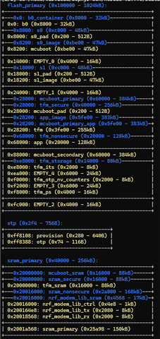

    I think I got this image correct, but feel free to check up against previously mentioned pm.yml files
