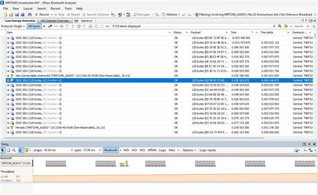

  • This is very similar to our default setting in broadcaster:
    As we can see, the broadcast stream occupied more than 40 % of airtime. So Lowering the retransmission time and bitrate could help.
