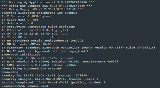

    What NCS version are you using? Could you test with the latest version NCS, v2.9.0?

    I cannot reproduce the issue. I can get the disconnection if I delete the nRF Connect for Mobile app job on the Android phone (Pixel 9).

    I have tried with NRF Connect APP and i have the same problem.
    In the next days, if I can, I will try with V2.9.0 and I will let you know.
    No, my app is not working in background I tried also to delete the app after the disconnection and I don't receive the disconnection message.
    The strange things is that instead using OPPO RENO 6 (phone that have the problem written above) I'll use Pixel 4a I do not have the problem. And android version is the same 13.
    I really can not undertstad what happen with OPPO RENO 6.
    Thanks
  • I would suggest you test with other Android phones. Maybe the issue is in OPPO RENO 6.
