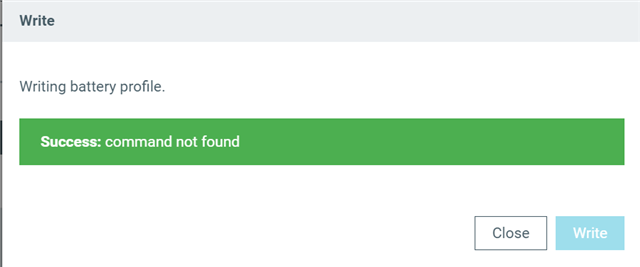

Unfortunately I encountered an issue when i tried to load this profile in my nPM1300-EK
I first got this success (but not successful :-) message :

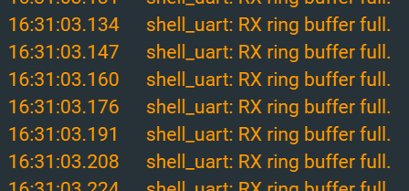

Then the logs reported this error :

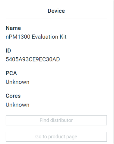

I did not find anything to upgrade the nPM Controller firmware or check version in the tool. Maybe there is another tool to do that ?

  • Try to see if there is a file named XY.json (XY - user set name) in the project folder you selected when configuring the battery profiling. Upload this file instead of profileSettings.json.
    We tested the file you uploaded. It worked after we extracted the batteryJson field from profileSettings.json and removed the escape characters (see attached json below). You may try by uploading the .json via this drop-down menu:
    Try uploading this and see if it helps:
    {"param_1": [0.0, 0.005, 0.01, 0.015, 0.02, 0.025, 0.03, 0.035, 0.04, 0.045, 0.05, 0.055, 0.06, 0.065, 0.07, 0.075, 0.08, 0.085, 0.09, 0.095, 0.1, 0.105, 0.11, 0.115, 0.12, 0.125, 0.13, 0.135, 0.14, 0.145, 0.15, 0.155, 0.16, 0.165, 0.17, 0.17500000000000002, 0.18, 0.185, 0.19, 0.195, 0.2, 0.20500000000000002, 0.21, 0.215, 0.22, 0.225, 0.23, 0.23500000000000001, 0.24, 0.245, 0.25, 0.255, 0.26, 0.265, 0.27, 0.275, 0.28, 0.28500000000000003, 0.29, 0.295, 0.3, 0.305, 0.31, 0.315, 0.32, 0.325, 0.33, 0.335, 0.34, 0.34500000000000003, 0.35000000000000003, 0.355, 0.36, 0.365, 0.37, 0.375, 0.38, 0.385, 0.39, 0.395, 0.4, 0.405, 0.41000000000000003, 0.41500000000000004, 0.42, 0.425, 0.43, 0.435, 0.44, 0.445, 0.45, 0.455, 0.46, 0.465, 0.47000000000000003, 0.47500000000000003, 0.48, 0.485, 0.49, 0.495, 0.5, 0.505, 0.51, 0.515, 0.52, 0.525, 0.53, 0.535, 0.54, 0.545, 0.55, 0.555, 0.56, 0.5650000000000001, 0.5700000000000001, 0.5750000000000001, 0.58, 0.585, 0.59, 0.595, 0.6, 0.605, 0.61, 0.615, 0.62, 0.625, 0.63, 0.635, 0.64, 0.645, 0.65, 0.655, 0.66, 0.665, 0.67, 0.675, 0.68, 0.685, 0.6900000000000001, 0.6950000000000001, 0.7000000000000001, 0.705, 0.71, 0.715, 0.72, 0.725, 0.73, 0.735, 0.74, 0.745, 0.75, 0.755, 0.76, 0.765, 0.77, 0.775, 0.78, 0.785, 0.79, 0.795, 0.8, 0.805, 0.81, 0.8150000000000001, 0.8200000000000001, 0.8250000000000001, 0.8300000000000001, 0.835, 0.84, 0.845, 0.85, 0.855, 0.86, 0.865, 0.87, 0.875, 0.88, 0.885, 0.89, 0.895, 0.9, 0.905, 0.91, 0.915, 0.92, 0.925, 0.93, 0.935, 0.9400000000000001, 0.9450000000000001, 0.9500000000000001, 0.9550000000000001, 0.96, 0.965, 0.97, 0.975, 0.98, 0.985, 0.99, 0.995, 1.0], "temps": [20.0], "param_2": [2.99, 3.0, 3.0100000000000002, 3.02, 3.0300000000000002, 3.04, 3.0500000000000003, 3.06, 3.0700000000000003, 3.08, 3.0900000000000003, 3.1, 3.1100000000000003, 3.12, 3.1300000000000003, 3.14, 3.1500000000000004, 3.16, 3.1700000000000004, 3.18, 3.1900000000000004, 3.2, 3.2100000000000004, 3.22, 3.2300000000000004, 3.24, 3.25, 3.2600000000000002, 3.2700000000000005, 3.2800000000000002, 3.29, 3.3000000000000003, 3.31, 3.3200000000000003, 3.33, 3.3400000000000003, 3.35, 3.3600000000000003, 3.37, 3.3800000000000003, 3.39, 3.4000000000000004, 3.41, 3.4200000000000004, 3.43, 3.4400000000000004, 3.45, 3.4600000000000004, 3.47, 3.4800000000000004, 3.49, 3.5, 3.5100000000000002, 3.5200000000000005, 3.5300000000000002, 3.54, 3.5500000000000003, 3.5600000000000005, 3.5700000000000003, 3.58, 3.5900000000000003, 3.6, 3.6100000000000003, 3.62, 3.6300000000000003, 3.64, 3.6500000000000004, 3.66, 3.6700000000000004, 3.68, 3.6900000000000004, 3.7, 3.71, 3.72, 3.7300000000000004, 3.74, 3.75, 3.7600000000000002, 3.7700000000000005, 3.7800000000000002, 3.79, 3.8000000000000003, 3.8100000000000005, 3.8200000000000003, 3.83, 3.8400000000000003, 3.85, 3.8600000000000003, 3.87, 3.8800000000000003, 3.89, 3.9000000000000004, 3.91, 3.9200000000000004, 3.93, 3.9400000000000004, 3.95, 3.96, 3.97, 3.9800000000000004, 3.99, 4.0, 4.01, 4.0200000000000005, 4.03, 4.04, 4.050000000000001, 4.0600000000000005, 4.07, 4.08, 4.09, 4.1000000000000005, 4.11, 4.12, 4.130000000000001, 4.140000000000001, 4.15, 4.16, 4.17, 4.18, 4.19, 4.2], "param_3": [0.14314863818067255, 0.15366035523245491, 0.15874138968696327, 0.160943867832391, 0.16264009664372397, 0.16430450000935165, 0.16564869219280576, 0.16693203443602606, 0.1681321970369178, 0.1691656852666636, 0.17003043505571522, 0.17081275956599465, 0.17150484261856813, 0.17205068088548717, 0.17242186466447934, 0.17267496561135567, 0.17290421229601963, 0.17313839237854595, 0.1732752387280197, 0.17337652864889952, 0.17349521677301374, 0.17360884129483192, 0.17373335015384933, 0.17382592700832444, 0.17387931307737586, 0.1739859738765211, 0.1741076111576772, 0.1742227744524147, 0.17434155786802352, 0.17443081407078434, 0.17461834894119216, 0.17492196170494712, 0.17515797499750432, 0.1753849528652747, 0.17560635728703675, 0.1757756686162752, 0.17593459774707423, 0.1761442980756843, 0.17637261050319386, 0.1765405720550964, 0.17675399879065282, 0.17697716442299638, 0.17714357084641366, 0.1773133984844345, 0.17749323871086703, 0.17766793224186392, 0.17782646139791902, 0.17796734224148186, 0.17809068438202164, 0.17820366647692187, 0.17832118714697084, 0.17845659210305487, 0.17860584415682898, 0.17875575667988103, 0.17889785461736069, 0.17904182401918609, 0.17920151154775432, 0.17937944165488978, 0.17955865619950814, 0.1797212855730253, 0.17986651159597966, 0.18000768637341397, 0.1801559811360126, 0.1803059092670966, 0.18044544592020645, 0.18056780160029348, 0.18068078852781122, 0.18079456920670028, 0.18091276124700106, 0.1810304610192503, 0.18114306845187808, 0.18125584948073198, 0.1813802930167086, 0.18152384414263886, 0.1816747602067337, 0.18181579966952768, 0.18193808342706702, 0.1820500478870187, 0.1821620162105132, 0.182278400075796, 0.18239775196736235, 0.18251821856855793, 0.1826367219661966, 0.18274960377812924, 0.18285712152020656, 0.18297279243565073, 0.18311274834271232, 0.18328180690817536, 0.18346718457762126, 0.183654881812483, 0.18383532628159557, 0.18400228054449866, 0.1841520213379623, 0.18429459003657286, 0.18444484939676453, 0.18461228224177217, 0.18479301249468325, 0.1849813358583759, 0.1851780517200361, 0.18539159581326808, 0.18562848389567357, 0.185872164769423, 0.1860930301263388, 0.18627256371577955, 0.18643836550789955, 0.18662962802278316, 0.1868617327892786, 0.18710596344467054, 0.18733035311505503, 0.18753180904227348, 0.18773299898218282, 0.1879540928261118, 0.1881917042080461, 0.1884324805845477, 0.1886673416566725, 0.1889001158825919, 0.18913688594148342, 0.18937670566779485, 0.189608830213874, 0.18982303857616384, 0.19002456296774017, 0.1902290584552465, 0.19044968580071972, 0.1906861651696266, 0.19093403555734434, 0.1911906465356756, 0.1914573626066608, 0.19173600086711345, 0.19202617979930317, 0.19232519461828051, 0.19262937711380834, 0.19292777529229965, 0.19320574241967478, 0.19345388274163772, 0.1936819985289767, 0.193904097419438, 0.19412273367038965, 0.19432141794792548, 0.1944836443839196, 0.19462141897292307, 0.19476967830751304, 0.19495709956891344, 0.19517004650910355, 0.19537888798904343, 0.19556409248114223, 0.19573330646341808, 0.1958986049009595, 0.1960690649983661, 0.19624997933329785, 0.19644563935213988, 0.19665213122355352, 0.1968605264650093, 0.19706375287677028, 0.19726336005095618, 0.19746330647023305, 0.19766755072766984, 0.19788005141633525, 0.19810453739245004, 0.19833999162666077, 0.19858093217507664, 0.1988217036167823, 0.19905665053086252, 0.19928011839028742, 0.19948845033151708, 0.1996842333532548, 0.19987127100434426, 0.200053366833629, 0.20023432438995292, 0.2004176201030728, 0.20060256221309594, 0.20078558545718728, 0.20096306767320893, 0.20113138669902297, 0.20128693180293392, 0.20142847469328706, 0.2015600827120305, 0.20168653666028466, 0.20181261733917027, 0.20194310554980788, 0.20208259892864663, 0.20223416037473482, 0.2024000870805952, 0.20258267060694474, 0.20278420251450036, 0.20300693421442026, 0.20325047890468767, 0.20351022299228566, 0.20378117272230767, 0.20405833433984724, 0.20433671408999782, 0.20461220765054017, 0.20488579489981978, 0.20516025928609066, 0.2054383863909703, 0.20572296179607621, 0.2060167710830259, 0.2063225998334369, 0.2066432336289268, 0.20698145805111287, 0.20734005868161276, 0.20772182110204393], "param_4": [0.007157431909033628, 0.007683017761622745, 0.007937069484348162, 0.008047193391619549, 0.008132004832186198, 0.008215225000467582, 0.008282434609640288, 0.008346601721801301, 0.00840660985184589, 0.008458284263333178, 0.00850152175278576, 0.008540637978299731, 0.008575242130928406, 0.008602534044274357, 0.008621093233223966, 0.008633748280567783, 0.008645210614800981, 0.008656919618927296, 0.008663761936400984, 0.008668826432444975, 0.008674760838650687, 0.008680442064741594, 0.008686667507692465, 0.00869129635041622, 0.008693965653868792, 0.008699298693826053, 0.008705380557883858, 0.008711138722620734, 0.008717077893401174, 0.008721540703539216, 0.008730917447059608, 0.008746098085247353, 0.008757898749875214, 0.008769247643263733, 0.008780317864351836, 0.00878878343081376, 0.008796729887353711, 0.008807214903784213, 0.008818630525159693, 0.008827028602754819, 0.008837699939532638, 0.008848858221149817, 0.008857178542320682, 0.008865669924221725, 0.00887466193554335, 0.008883396612093194, 0.00889132306989595, 0.008898367112074092, 0.008904534219101081, 0.008910183323846093, 0.008916059357348542, 0.008922829605152742, 0.008930292207841447, 0.00893778783399405, 0.008944892730868034, 0.008952091200959302, 0.008960075577387715, 0.008968972082744487, 0.008977932809975407, 0.008986064278651264, 0.008993325579798983, 0.009000384318670698, 0.00900779905680063, 0.00901529546335483, 0.009022272296010322, 0.009028390080014673, 0.009034039426390559, 0.009039728460335014, 0.009045638062350052, 0.009051523050962514, 0.009057153422593903, 0.009062792474036598, 0.00906901465083543, 0.009076192207131942, 0.009083738010336684, 0.009090789983476384, 0.00909690417135335, 0.009102502394350934, 0.009108100810525658, 0.009113920003789798, 0.009119887598368117, 0.009125910928427895, 0.009131836098309828, 0.00913748018890646, 0.009142856076010326, 0.009148639621782535, 0.009155637417135615, 0.009164090345408767, 0.00917335922888106, 0.009182744090624148, 0.009191766314079777, 0.009200114027224931, 0.009207601066898113, 0.009214729501828643, 0.009222242469838226, 0.009230614112088607, 0.00923965062473416, 0.009249066792918793, 0.009258902586001804, 0.009269579790663403, 0.009281424194783677, 0.00929360823847115, 0.009304651506316939, 0.009313628185788975, 0.009321918275394976, 0.009331481401139156, 0.009343086639463928, 0.009355298172233526, 0.00936651765575275, 0.009376590452113674, 0.00938664994910914, 0.00939770464130559, 0.009409585210402303, 0.009421624029227384, 0.009433367082833625, 0.009445005794129593, 0.00945684429707417, 0.00946883528338974, 0.009480441510693698, 0.009491151928808192, 0.009501228148387008, 0.009511452922762323, 0.009522484290035984, 0.009534308258481328, 0.009546701777867216, 0.00955953232678378, 0.009572868130333038, 0.009586800043355671, 0.009601308989965158, 0.009616259730914024, 0.009631468855690417, 0.009646388764614981, 0.009660287120983739, 0.009672694137081885, 0.009684099926448832, 0.0096952048709719, 0.009706136683519481, 0.009716070897396272, 0.009724182219195979, 0.009731070948646153, 0.009738483915375651, 0.009747854978445672, 0.009758502325455177, 0.009768944399452171, 0.00977820462405711, 0.009786665323170903, 0.009794930245047974, 0.009803453249918303, 0.009812498966664892, 0.009822281967606993, 0.009832606561177674, 0.009843026323250464, 0.009853187643838511, 0.009863168002547808, 0.009873165323511651, 0.00988337753638349, 0.009894002570816761, 0.0099052268696225, 0.009916999581333038, 0.00992904660875383, 0.009941085180839113, 0.009952832526543125, 0.00996400591951437, 0.009974422516575853, 0.009984211667662739, 0.00999356355021721, 0.01000266834168145, 0.010011716219497644, 0.010020881005153639, 0.010030128110654795, 0.010039279272859363, 0.010048153383660446, 0.010056569334951146, 0.010064346590146695, 0.010071423734664351, 0.010078004135601523, 0.010084326833014232, 0.010090630866958513, 0.010097155277490392, 0.01010412994643233, 0.01011170801873674, 0.010120004354029759, 0.010129133530347235, 0.010139210125725016, 0.010150346710721011, 0.010162523945234382, 0.010175511149614281, 0.010189058636115383, 0.01020291671699236, 0.01021683570449989, 0.010230610382527006, 0.010244289744990987, 0.010258012964304532, 0.010271919319548514, 0.010286148089803809, 0.010300838554151294, 0.010316129991671844, 0.010332161681446338, 0.010349072902555642, 0.010367002934080636, 0.010386091055102195], "param_5": [0.10511717051782353, 0.07796375753145345, 0.03641756299968034, 0.01949353478380364, 0.016803160884803353, 0.015042977745408949, 0.01313767213337192, 0.012417524220560174, 0.011168254153187673, 0.009491190093987092, 0.008235371496655326, 0.007372037814264501, 0.006189606597462559, 0.004585110229556044, 0.0031214236293425693, 0.002411738157701536, 0.0023171338359512933, 0.0018551321600002169, 0.0011906813517679332, 0.001099890224970368, 0.0011615632296619119, 0.0011906669041777604, 0.0010854285674625694, 0.0007298146176327319, 0.0008002343409833565, 0.0011414904015065452, 0.001184002879468099, 0.0011697335517316804, 0.0010401980918482018, 0.0013839553658433201, 0.0024557381708137024, 0.0026981302815606498, 0.0023149558016379718, 0.0022419114476621843, 0.0019535787550026273, 0.0016412023001875081, 0.0018431472970453777, 0.0021900637805981685, 0.0019813698970605823, 0.0019069414372945709, 0.0021829618394997655, 0.0019478602788043295, 0.001681170307190824, 0.0017483393222668397, 0.0017726687871469013, 0.0016661134352599638, 0.0014970499980898264, 0.0013211149205131709, 0.001181621177200054, 0.0011525138247460431, 0.0012646281306649687, 0.0014232850492904708, 0.0014958228841307694, 0.0014600523026587348, 0.001430336696525182, 0.0015182846519681478, 0.0016880881785185167, 0.0017857232587691757, 0.0017092195906776714, 0.0015392769823575903, 0.0014320040019433905, 0.0014473477001647472, 0.0014911144684132127, 0.0014473239209691208, 0.0013094616659842934, 0.001176713038023719, 0.0011338380320340818, 0.0011598635959493217, 0.0011794590627500767, 0.0011515360243850511, 0.0011269423074083962, 0.0011861228241526536, 0.0013399733095343855, 0.0014723359501254626, 0.0014597776344441732, 0.0013166161016665498, 0.0011712410874550189, 0.0011196639172308606, 0.0011417609438863635, 0.0011786787842459415, 0.0011990924638096909, 0.0011948499941710766, 0.0011569260478565269, 0.0011019977700497952, 0.0011159432876075431, 0.0012781341125289378, 0.0015450723626232038, 0.0017721811745445223, 0.0018653745215381143, 0.0018407085198715936, 0.001736993660078276, 0.0015834752818336476, 0.0014615474603711306, 0.0014641402940112833, 0.001588461025996482, 0.0017408154895934627, 0.001845268083018603, 0.0019251961267643253, 0.0020512997744609462, 0.0022521608781873176, 0.0024028447807746336, 0.0023227311533261658, 0.0020019947317826206, 0.0017266769078037522, 0.0017853215350180363, 0.0021168364068952297, 0.0023816771094370068, 0.0023431016288821827, 0.0021292279880147716, 0.0020132293356390357, 0.00211141891919165, 0.0022935261293162423, 0.0023919387921794363, 0.0023781872431322126, 0.002338176490220868, 0.002347721424054462, 0.0023829489260147538, 0.0023597213619528518, 0.002231664541845098, 0.0020786637693309684, 0.002030099395413168, 0.002125614164897628, 0.0022855335719005124, 0.0024217487831231996, 0.0025224068302451275, 0.0026166352465821496, 0.0027267716571891323, 0.0028440859632120064, 0.0029459687558353043, 0.003015986572525893, 0.0030129033700957222, 0.002881826529332193, 0.002630537246690358, 0.002381280546509372, 0.0022510733890014623, 0.002203675707064881, 0.00208660264243727, 0.001804553567649747, 0.0015000051249880464, 0.0014301696179672488, 0.0016784029799519345, 0.002001841007952601, 0.0021089421006498937, 0.0019702298601933024, 0.0017720923718732295, 0.0016725620990863319, 0.0016787926747400053, 0.0017568721616918054, 0.0018828717688689975, 0.0020107594512782864, 0.0020744355643470894, 0.0020581082660836927, 0.002014167929734363, 0.0019977679673139834, 0.0020209533835682456, 0.0020837247305109663, 0.002184933323901017, 0.002299701051627738, 0.002381973913133037, 0.002408559950607507, 0.002378591778929434, 0.0022920738675257304, 0.002158999003272835, 0.002020574814836848, 0.0019141033641357358, 0.0018456674018710664, 0.0018152669280433603, 0.0018212663472188736, 0.0018411891157150972, 0.0018398267705724974, 0.001802527300565071, 0.001729006209178277, 0.001619320648624939, 0.0014854399713205152, 0.0013657545454827391, 0.0012903098349880196, 0.001262673135699055, 0.001282844447616019, 0.0013499079473816566, 0.0014552741246348297, 0.0015874407597428822, 0.001742551161049502, 0.0019205771695257612, 0.0021213180373775772, 0.0023313819509365383, 0.002516443889327008, 0.0026534690881001646, 0.0027405567378079726, 0.0027777068384506054, 0.0027693665534645265, 0.0027454040491097995, 0.0027402581777526483, 0.0027629574557526057, 0.0028135125499276215, 0.0028919234602780425, 0.002998190186803522, 0.0031323127295044065, 0.003294291088379829, 0.0034841252634297895, 0.0037018152546553287, 0.0038176242043119063], "param_6": [2.1023434103564718, 1.5592751506290718, 0.7283512599936093, 0.38987069567607, 0.3360632176960643, 0.3008595549081783, 0.2627534426674405, 0.24835048441120555, 0.22336508306375347, 0.18982380187974046, 0.16470742993310583, 0.1474407562852914, 0.12379213194925187, 0.09170220459112088, 0.06242847258685069, 0.04823476315402864, 0.046342676719027254, 0.03710264320000711, 0.023813627035357277, 0.021997804499404583, 0.02323126459324032, 0.023813338083558677, 0.02170857134925208, 0.01459629235265325, 0.016004686819665048, 0.02282980803013368, 0.02368005758936198, 0.02339467103463222, 0.020803961836962648, 0.027679107316863627, 0.04911476341627752, 0.053962605631216465, 0.04629911603275805, 0.0448382289532423, 0.03907157510004977, 0.032824046003748775, 0.03686294594091033, 0.043801275611962676, 0.03962739794121095, 0.03813882874589558, 0.04365923678999739, 0.03895720557608451, 0.03362340614381232, 0.034966786445336795, 0.035453375742941495, 0.033322268705199276, 0.029940999961794446, 0.026422298410261336, 0.02363242354400108, 0.023050276494920863, 0.025292562613299374, 0.02846570098581358, 0.029916457682616082, 0.029201046053170532, 0.028606733930505723, 0.03036569303936365, 0.03376176357036964, 0.035714465175382126, 0.03418439181355204, 0.030785539647151805, 0.028640080038866422, 0.028946954003294945, 0.029822289368264254, 0.028946478419383803, 0.026189233319687255, 0.023534260760477155, 0.02267676064068025, 0.023197271918984352, 0.023589181255001535, 0.023030720487701717, 0.022538846148167924, 0.02372245648305238, 0.026799466190688404, 0.029446719002509947, 0.029195552688882076, 0.02633232203333169, 0.023424821749101765, 0.022393278344617906, 0.022835218877728658, 0.02357357568491536, 0.02398184927619451, 0.023896999883424308, 0.023138520957130537, 0.022039955400995903, 0.022318865752149475, 0.025562682250576674, 0.030901447252462688, 0.035443623490893916, 0.03730749043076298, 0.03681417039743118, 0.034739873201566907, 0.03166950563667226, 0.02923094920742053, 0.029282805880223584, 0.03176922051993103, 0.034816309791871336, 0.03690536166037206, 0.03850392253528512, 0.041025995489218925, 0.04504321756374774, 0.04805689561549198, 0.04645462306652193, 0.040039894635654494, 0.03453353815607574, 0.035706430700360725, 0.0423367281379039, 0.047633542188738054, 0.04686203257764365, 0.04258455976029474, 0.04026458671277933, 0.04222837838383231, 0.04587052258632762, 0.04783877584358942, 0.04756374486264148, 0.046763529804419446, 0.046954428481091326, 0.04765897852029577, 0.04719442723905842, 0.04463329083689849, 0.04157327538661659, 0.04060198790826752, 0.042512283297954645, 0.045710671438009554, 0.04843497566246191, 0.050448136604899774, 0.05233270493164577, 0.05453543314378473, 0.05688171926423735, 0.058919375116706085, 0.06031973145051717, 0.06025806740191375, 0.057636530586643864, 0.052610744933806464, 0.04762561093019091, 0.045021467780029245, 0.04407351414129623, 0.04173205284874748, 0.03609107135299494, 0.030000102499758152, 0.028603392359344282, 0.0335680595990373, 0.040036820159050635, 0.04217884201299926, 0.03940459720386813, 0.03544184743746459, 0.03345124198172733, 0.03357585349480219, 0.03513744323383472, 0.03765743537737787, 0.04021518902556642, 0.04148871128694109, 0.041162165321675936, 0.040283358594689345, 0.039955359346277586, 0.040419067671365605, 0.041674494610219326, 0.04369866647802034, 0.04599402103255268, 0.04763947826265935, 0.04817119901215361, 0.047571835578588684, 0.04584147735051114, 0.043179980065455315, 0.04041149629673835, 0.03828206728271888, 0.036913348037420635, 0.03630533856086582, 0.03642532694437817, 0.036823782314301945, 0.03679653541144856, 0.036050546011298645, 0.034580124183569705, 0.03238641297249878, 0.029708799426408916, 0.027315090909657558, 0.025806196699759698, 0.025253462713978325, 0.025656888952321766, 0.02699815894763591, 0.029105482492694512, 0.03174881519485695, 0.03485102322099143, 0.038411543390515224, 0.04242636074755224, 0.04662763901873146, 0.05032887778654016, 0.05306938176199982, 0.054811134756158064, 0.055554136769014884, 0.05538733106929261, 0.05490808098219668, 0.054805163555049496, 0.05525914911505281, 0.056270250998555205, 0.05783846920555946, 0.059963803736068355, 0.06264625459009021, 0.06588582176759727, 0.0696825052685951, 0.07403630509310588, 0.07635248408623396], "param_7": [0.00014183303136619475, 0.00015366528820388704, 0.0001654975450415798, 0.00017732980187927207, 0.00018916205871696493, 0.00020099431555465719, 0.00021282657239235, 0.0002246588292300423, 0.0002364910860677351, 0.00024832334290542736, 0.00027167639371851704, 0.00029615513659566494, 0.0003206338794728139, 0.00034511262234996167, 0.00036959136522711066, 0.0003940701081042584, 0.00041854885098140733, 0.0004430275938585552, 0.00046750633673570406, 0.0004919850796128518, 0.0005396110498695477, 0.0005960825913556866, 0.0006525541328418284, 0.0007090256743279677, 0.0007706806589339061, 0.0008440064597520738, 0.0009173322605702411, 0.0009906580613884119, 0.0010652549964626317, 0.001139982877053605, 0.001214710757644579, 0.001299576219508098, 0.0013921056490739142, 0.0014846350786397343, 0.0015810006430860058, 0.0016779173748611106, 0.0017768577453768004, 0.0018804914828965584, 0.0019841252204163117, 0.0021027165184608733, 0.002223063642290657, 0.002362732856732958, 0.002507911647923167, 0.002666895975178134, 0.002836668620308427, 0.003022776997360114, 0.003254757360070307, 0.003635826810162566, 0.004163729498228123, 0.005143068211231885, 0.006396098276770684, 0.0074084818127879625, 0.007879004319913592, 0.008427824830120396, 0.009126507087923964, 0.00974675445572122, 0.010344614860087989, 0.011062317507560602, 0.0118976498322372, 0.012880315997199333, 0.013732178448179621, 0.014453356851241283, 0.015282916155859333, 0.01617039892851756, 0.01724445416221634, 0.018241322056047417, 0.0191905019941121, 0.02025299956923755, 0.021321025128615678, 0.022043404600058, 0.02275591824754652, 0.02358110930627243, 0.02426060687669352, 0.024840464331556244, 0.02537078927405046, 0.026059418892929592, 0.02660819770712463, 0.027181256397716177, 0.027760385157097948, 0.028281694300138757, 0.028812398520937442, 0.029337645829599746, 0.02992564395415891, 0.030501981229526087, 0.03100860917721727, 0.03147857709958228, 0.03191484578791919, 0.03232821935894429, 0.03274878601388664, 0.03323521798440089, 0.03379228825476819, 0.03446839518244788, 0.03522693624545257, 0.03583903463043186, 0.036571907813687715, 0.037233298486125235, 0.03783618676385905, 0.03845640385047266, 0.03904153193823127, 0.0395709785975437, 0.04009214304460097, 0.040664678524564714, 0.041323423927905736, 0.04200466187251606, 0.04269441468886946, 0.04351996249551511, 0.044481823010256126, 0.045265105251123934, 0.045869146778860434, 0.04636584515303544, 0.046821331535920906, 0.04726981775981778, 0.04772335960941315, 0.04817164926576796, 0.04860149432962892, 0.049003173367586465, 0.049377313539823206, 0.049718195331179965, 0.04987531172069826, 0.04987531172069826, 0.04987531172069826, 0.04987531172069826], "param_8": [0.000007092, 0.00000768, 0.00000827, 0.00000887, 0.00000946, 0.00001005, 0.00001064, 0.00001123, 0.00001182, 0.00001242, 0.00001358, 0.00001481, 0.00001603, 0.00001726, 0.00001848, 0.00001970, 0.00002093, 0.00002215, 0.00002338, 0.00002460, 0.00002698, 0.00002980, 0.00003263, 0.00003545, 0.00003853, 0.00004220, 0.00004587, 0.00004953, 0.00005326, 0.00005700, 0.00006074, 0.0000650, 0.0000696, 0.0000742, 0.0000791, 0.0000839, 0.0000888, 0.0000940, 0.0000992, 0.00010513582592304366, 0.00011115318211453283, 0.0001181366428366479, 0.00012539558239615833, 0.00013334479875890668, 0.00014183343101542133, 0.00015113884986800566, 0.00016273786800351532, 0.00018179134050812825, 0.00020818647491140614, 0.0002571534105615942, 0.0003198049138385341, 0.00037042409063939806, 0.0003939502159956795, 0.00042139124150601974, 0.00045632535439619814, 0.0004873377227860609, 0.0005172307430043995, 0.00055311587537803, 0.00059488249161186, 0.0006440157998599665, 0.000686608922408981, 0.000722667842562064, 0.0007641458077929666, 0.0008085199464258779, 0.000862222708110817, 0.0009120661028023707, 0.0009595250997056049, 0.0010126499784618773, 0.0010660512564307837, 0.0011021702300029, 0.001137795912377326, 0.0011790554653136214, 0.001213030343834676, 0.001242023216577812, 0.001268539463702523, 0.0013029709446464796, 0.0013304098853562313, 0.0013590628198858086, 0.0013880192578548973, 0.0014140847150069377, 0.001440619926046872, 0.0014668822914799871, 0.0014962821977079453, 0.0015250990614763041, 0.0015504304588608634, 0.0015739288549791138, 0.0015957422893959595, 0.0016164109679472141, 0.0016374393006943317, 0.0016617608992200443, 0.001689614412738409, 0.001723419759122394, 0.001761346812272628, 0.0017919517315215926, 0.0018285953906843856, 0.0018616649243062614, 0.0018918093381929525, 0.0019228201925236327, 0.001952076596911563, 0.0019785489298771845, 0.0020046071522300483, 0.0020332339262282353, 0.0020661711963952866, 0.002100233093625803, 0.0021347207344434727, 0.0021759981247757554, 0.002224091150512806, 0.0022632552625561964, 0.0022934573389430217, 0.002318292257651772, 0.0023410665767960447, 0.0023634908879908885, 0.002386167980470657, 0.002408582463288398, 0.0024300747164814457, 0.002450158668379323, 0.00246886567699116, 0.002485909766558998, 0.0024937655860349127, 0.0024937655860349127, 0.0024937655860349127, 0.0024937655860349127], "param_9": [1.5652553114636778], "param_10": [232.15297796383055, 78.3844537316521], "param_11": [0.9883947289830266, 0.6788300556478964], "param_12": [0.1351712985663705], "name": "KineticLP302025"}
  • Thank you very much helsing
    Working perfectly with the  batteryJson field only
