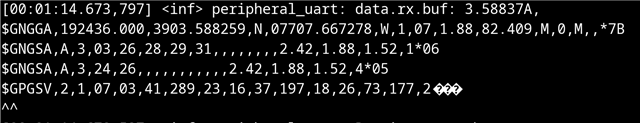

After few minutes of running it starts leaking memory by not releasing RX buffers. Using RTT messages I identified it correspond to non-standard bytes. Especially often to 0x0092 and few others.
The uart_cb function in main.c was modified for debugging:

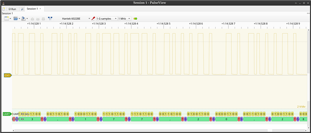

To rule out noise issues I recorded the signal with an oscilloscope
As you can see, there is no non-display symbols. And there is no noise.
Where should I focus on?

  • Looks like it is a hardware problem on the GPS module side
    Will try to figure out how to handle it
