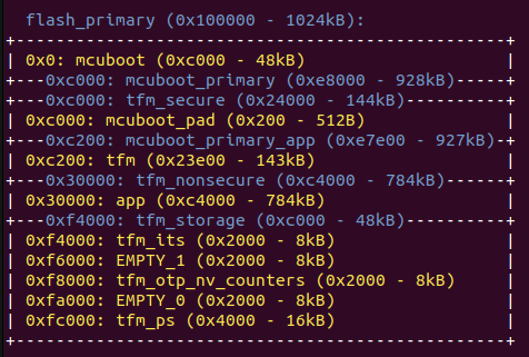

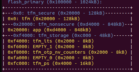

    Them moving on to the second item, the CONFIG_PM_PARTITION_SIZE_TFM:
    You need to change the size of the TF-M partition so that it follows the requirement that the secure and non-secure partition addresses are aligned with the TrustZone flash region size This can be done by changing CONFIG_PM_PARTITION_SIZE_TFM.
    From a discussion with my colleague, the following example should explain how you can achieve this: For example if the default value in the sample you've based your application on is set to 0x20000 in the sample, such that the TF-M partition is from 0x0 to 0x20000, with tfm_secure starting at 0x0 and tfm_nonsecure starting at 0x20000 so that they are both aligned to 0x4000:
    However, when you add MCUboot to your project, partition manager will add an MCUboot partition from 0x0 to 0xc000, causing TF-M to start at 0xc000 instead. This will shift tfm_secure in such a way that the start of tfm_nonsecure will no longer be aligned with 0x4000, so you need to change the size of TF-M to ensure that both tfm_secure and tfm_nonsecure are still aligned.
    Andreas
