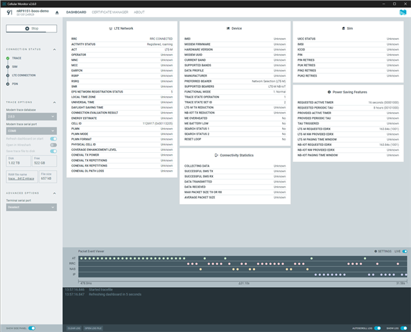

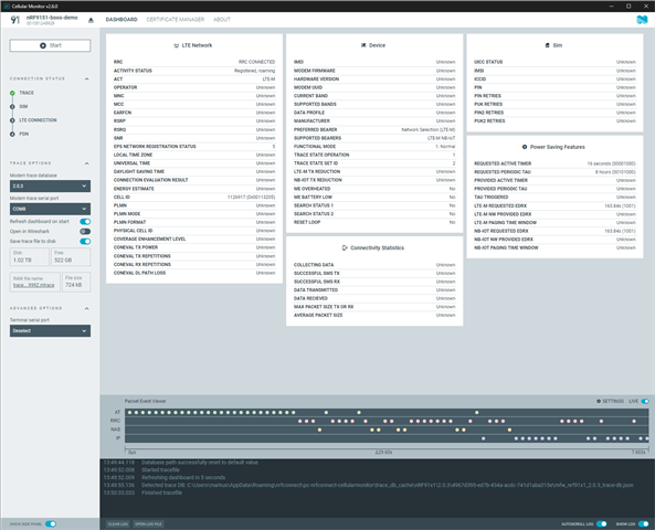

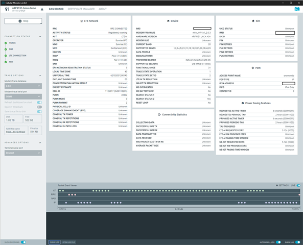

    I tried
    1. Build and flash the Exercise 1 from Lesson 7: only few data updated in Cellular Monitor
    2. Build and flash the Exercise 1 solution from Lesson 7: only few data updated in Cellular Monitor

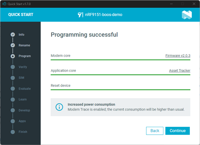

    3. Flash Asset Tracker Demo via Quick Start: Values updated I would expect
    First Try
    Build and flash the Exercise 1 from Lesson 7: only few data updated in Cellular Monitor.
    First Try
    Second Try
    Second Try
    Third Try
    Asset Tracker Demo
    Asset Tracker CM
    Questions
    Why does the Asset Tracker reveal more data in the cellular monitor?
    Are there any additional settings required in the exercise code to activate/enable?
