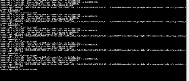

i have created a custom service and added one characteristics in ble_nfc_pairing_example i have received error regarding to no memory i=when i try to add my base uuid to soft device.
how to solve that error

Please refer to the log to modify the RAM start location and size from Project -> Options.
