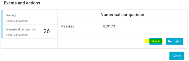

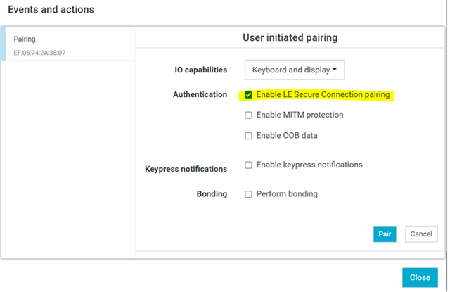

    To pair with Peripheral UART from the nRF BLE app, you need to enable LESC pairing
    Then it will ask if the key matches like this
    After confirming on the nRF BLE app, then it will ask to confirm from the DK in the RTT log. Pressing Button 1 on DK to pair. It would show the security change without error.
    -Amanda H.
