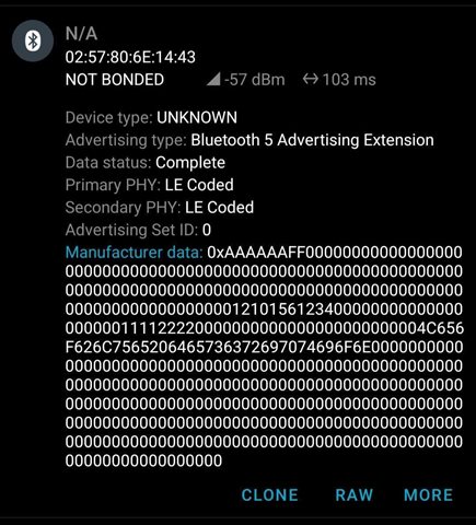

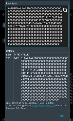

Impossible to scan extended advertising data when the data size is bigger than 31 Bytes.
I need to scan the advertising data of my peripheral wich advertise with extended advertsing and LE coded PHY.
I use zephyr 3.7, and I work if I use the BLE controller from Zephyr but that doesn't work with SoftDevice controller... I'm limited to 31 Bytes.
If my advertising data is smaller than 32 Bytes, it works.
here my scan config.
