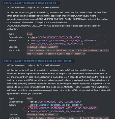

Unable to find bootable image using the direct-xip with revert boot mode.
I am facing a similar issue described in  https://devzone.nordicsemi.com/f/nordic-q-a/97084/direct-xip-mcuboot-both-images-have-the-same-version  where mcuboot is unable to find any bootable image after flashing the device using the direct-xip with revert boot mode. However, this issue does not exist if I use direct-xip without revert and everything works as intended when doing DFU. Therefore, I am wondering if there are any KConfig changes or extra settings that I will need to make to enable support for direct-xip with revert (I am using NCS 2.7.0). Thanks for the help in advance!
