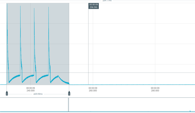

Im using a custom NRF52811 board and on this board we are using the internal RC as LFCLK source. I have a single thread that sleeps every 10 seconds, so during 10 seconds the system is sleeping (consumes more less 1.35 micro amp). However, the wake up time seems to be quite a lot - around 20ms. I attached the power profiling bellow. Any idea how this can be reduced ?

    How tall are the spikes in your screenshot? 1mA? 5mA?
    How do you tell the device to wake up in 10 seconds, and when it wakes up, what does it do?

    So these spikes reach a max of 4mA. What Im basically doing is put the device to sleep using k_sleep and wake up to increment a variable.
