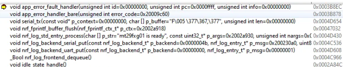

nrf_log_backend_uart error 11
MCU : nrf52840
SDK :  sdk_17.1.0
Hello, we are developing a product using the nRF52840.
However, we have observed that while the nrf_log_backend_uart~ function is operating, it returns error code 11, causing the device to reset.
Our device uses the following two UARTs:
  • backend_uart: for logging
  • jig_uart: for communication with the test jig
The jig_uart operates only during production and is implemented as a separate task (uartTask).
We confirmed that changing the idle_state_handle function in uartTask to the sub_idle_state_handle below resolved the device reset issue:

In conclusion, we suspect that the NRF_LOG_PROCESS() in idle_state_handle could be causing a problem when used in parallel in two different tasks. However, we haven't found any mention of this anywhere, so we're reaching out to inquire.
Could the NRF_LOG_PROCESS() function cause error code 11 when used in two different tasks? Thank you.
    You MUST NOT call idle_state_handle() and everything in it from more than one task. Otherwise you will risk bad behavior like faults.
    Think of it, there can be only ONE true idle state task on a single core CPU.
    I assume the error is 0x11==17=NRF_ERROR_BUSY?  NRF_LOG_PROCESS() should only be called from the main context. Otherwise, there's a risk of the UART send function being called again while it's still sending data, which will result in a busy error. If you need logs to be processed in place, you can disable the NRF_LOG_DEFERRED symbol in sdk_config.h and remove the NRF_LOG_PROCESS() calls.
