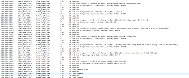

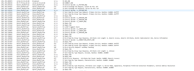

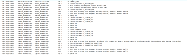

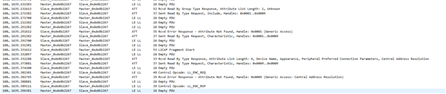

    I found a device which has the issue but I don't really see the problem in sniffer..

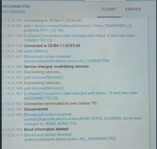

    Also, from nRF connect mobile app I can see the logs:
    Please let me know if you can find any information from sniffer screenshots..
    Also, I noticed that bonding is performed successfully the first time, but afterwards, if we disconnect it will ask to bond again, and repairing process will start. Also, sometimes GATT error 133 appeared. So, since I know that the peripheral device (nRF52832) did not erase the bonds, something happens and the phone deletes it. I dont know why but I had an idea that maybe PM_HANDLER_SEC_DELAY_MS is related to it..
