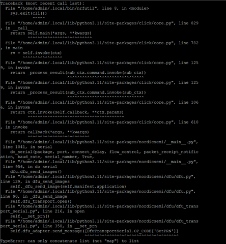

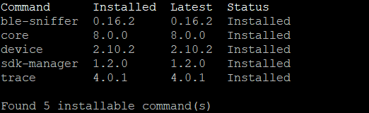

  • My device uses NRF52832. Now I need to use Raspberry Pi 5 to upgrade it with ble or cli.
    1 But the nrfutil (Arm64 version) released now cannot use the dfu function and cannot be upgraded.(can not install nrf5sdk-tools)
    2 pip instsall nrfutil because the latest version can only download 5.2.0. There is a problem when using serial upgrade. It may be necessary to downgrade Python2. But we must use Python3.
    This is the error message when doing dfu upgrade with nrfutil V5.2.0. And I use python3.11.2.
    I would like to ask if there is a good way to do dfu on Raspberry Pi 5?
