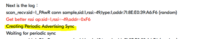

    I add a timer like this:
    k_timer_start(&my_timer, K_SECONDS(1), K_SECONDS(1));
    void timer_func(struct k_timer *timer_id)
        secondTick++;
    Init startScan  when scan starts:  startScan = secondTick;
    static void scan_AP(const struct bt_le_scan_recv_info *info)
        if (info->rssi > AP_info.rssi){
            AP_info.sid = info->sid;
            AP_info.rssi = info->rssi;
            bt_addr_le_copy(&(AP_info.addr), info->addr);
            printk("Get better rssi ap:sid=%d,rssi=%i,addr=0x%X\n", AP_info.sid, AP_info.rssi, AP_info.addr.a.val[0]);
    static void scan_recv(const struct bt_le_scan_recv_info *info, struct net_buf_simple *buf)
        char name[NAME_LEN] = {0};
        char le_addr[BT_ADDR_LE_STR_LEN];
        (void)memset(name, 0, sizeof(name));
        bt_data_parse(buf, data_cb, name);
        bt_addr_le_to_str(info->addr, le_addr, sizeof(le_addr));
        if (0 == strstr(name, "PAwR conn sample") || 0 == info->interval){
            return;
        printk("scan_recv:%s,sid:%d,rssi:%i,type:%d,addr:%s\n", name, info->sid, info->rssi, info->addr->type, le_addr);
        scan_AP(info);
    if ( !per_adv_found && (secondTick-startScan>5) ){
            per_sid = AP_info.sid;
            bt_addr_le_copy(&per_addr, &(AP_info.addr));
            per_adv_found = true;
            k_sem_give(&sem_per_adv);
    Next is the log:

    Next is the log:
    scan_recv:sid=1_PAwR conn sample,sid:1,rssi:-49,type:1,addr:71:8E:E0:39:A6:F6 (random)
    Get better rssi ap:sid=1,rssi=-49,addr=0xF6
    Creating Periodic Advertising Sync
    Waiting for periodic sync
    scan_recv:sid=1_PAwR conn sample,sid:1,rssi:-48,type:1,addr:71:8E:E0:39:A6:F6 (random)
    Get better rssi ap:sid=1,rssi=-48,addr=0xF6
    scan_recv:sid=2_PAwR conn sample,sid:2,rssi:-47,type:1,addr:79:D7:19:CA:C1:9D (random)
    scan_recv:sid=1_PAwR conn sample,sid:1,rssi:-47,type:1,addr:71:8E:E0:39:A6:F6 (random)
    scan_recv:sid=2_PAwR conn sample,sid:2,rssi:-49,type:1,addr:79:D7:19:CA:C1:9D (random)
    scan_recv:sid=3_PAwR conn sample,sid:3,rssi:-54,type:1,addr:60:A5:88:64:00:6F (random)
    scan_recv:sid=2_PAwR conn sample,sid:2,rssi:-45,type:1,addr:79:D7:19:CA:C1:9D (random)
    scan_recv:sid=1_PAwR conn sample,sid:1,rssi:-58,type:1,addr:71:8E:E0:39:A6:F6 (random)
    scan_recv:sid=1_PAwR conn sample,sid:1,rssi:-52,type:1,addr:71:8E:E0:39:A6:F6 (random)
    scan_recv:sid=2_PAwR conn sample,sid:2,rssi:-46,type:1,addr:79:D7:19:CA:C1:9D (random)
    Synced to sid=1,addr_info_71:8E:E0:39:A6:F6 (random),service_data_0 has 128 subevents,phy=2,reassembly.len=0:0 0 0.
    Rx_2, sub_0, RSSI=-47, len=0, data: 0xde_92_35
    Periodic sync established.
    Stopped scanning
    Rx_2, sub_1, RSSI=-48, len=0, data: 0xde_92_35
  • Hi Tan,
    As you can see in your log:
    Creating Periodic Advertising Sync is printed right after the first AP is captured. So you need to check what's wrong with the check if (!per_adv_found && second_cnt>5) . Is 5 seconds too short. Or if the second_cnt is counting correctly or not or the if condition was correct or not. Please try to print the log out.
    I don't think this is something very hard to debug. Please show the log with all the output, for example the second_cnt print out in the timer handler and in the if (!per_adv_found && second_cnt>5)
    I think what you implement is OK , about the timer. You can increase the timer to 10 sec just to test.
