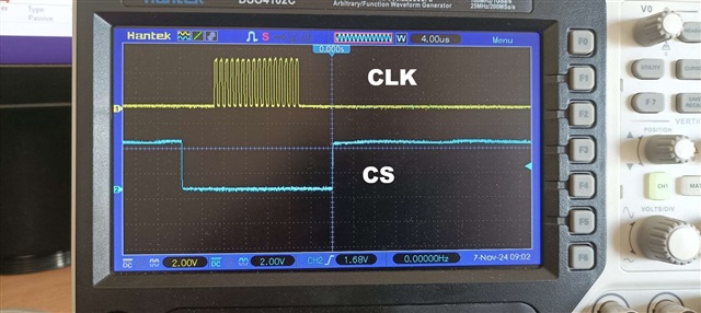

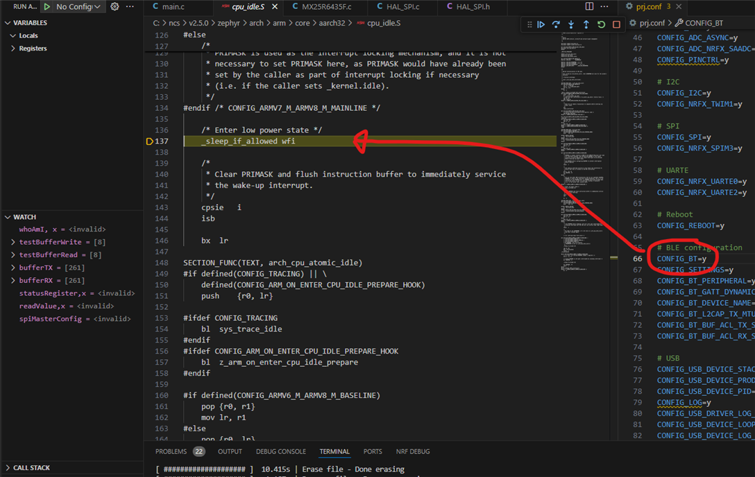

Hi, in our project we use nRF5340 to control some externanal peripherals as flash mem through SPI and also we need BLE comunication.
The case is if whe allow the config for the BLE the sistems fall down.
And if set the BLE config in "n" works fine.

Why doesn't work the system with this configuration when is set "y" in "CONFIG_BT"?

    What board are you building for? And what pin are you using for your MOSI?

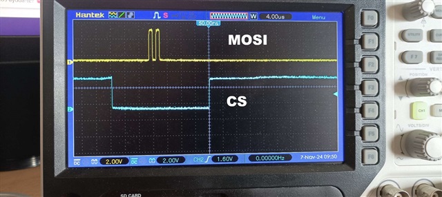

    Anyway, now assuming that you are building for the nrf7002dk_nrf5340_cpuapp, and it looks like you are trying to use MOSI pin P1.05, and it fails when enabling bluetooth, this is likely because the network core is enabled, and then, the pin P1.05 is used by the network core's UART (if you look on the back of the DK, it is listed as an RTS pin (flow control in UART).
    Actually, you will run into a similar issue if you were to build for the nRF5340dk_nrf5340_cpuapp if you try to add the 7002 Evaluation Kit, so there is an overlay file that disables the GPIO forwarding to the network core for this:
    https://github.com/nrfconnect/sdk-nrf/blob/v2.5.0/boards/shields/nrf7002ek/boards/nrf5340dk_nrf5340_cpuapp.overlay
    Try to create your own overlay file called nrf7002dk_nrf5340_cpuapp.overlay, and include the last part of that overlay file into it:
    &gpio_fwd {
    	status = "disabled";
    This will disable the pin forwarding that is initially set up in v2.5.0\nrf\boards\arm\nrf7002dk_nrf5340\nrf5340_cpuapp_common.dts on line 92:
    	gpio_fwd: nrf-gpio-forwarder {
    		compatible = "nordic,nrf-gpio-forwarder";
    		status = "okay";
    		uart {
    			gpios = <&gpio1 1 0>, <&gpio1 0 0>, <&gpio1 5 0>, <&gpio1 4 0>;
    Since you disable the UART gpios on the network core, you can also disable the logging on the network core, by adding a folder called "child_image", and inside that, add a file called hci_rpmsg.conf. This will be added to your network core's configuration. In it, add:

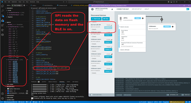

  • Hello Edvin, after check and add all of points you list finally the SPI comunication works fine with the BLE active.
    Many thanks by your support and your time.
